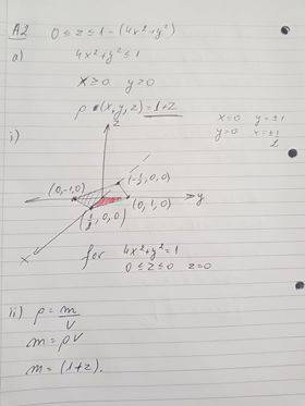

Handwritten solution sheet for a mass calculation: region 0 ≤ z ≤ 1 − (4x² + y²), density ρ = 1 + z, with a 3D sketch of the first-octant region and its intercepts, and mass m = ρV written below.
I am not sure what equation to use for the volume[/B]

The attempt that you posted is too small and I cannot click on it to get a better view. But from what I can see, I suggest the following.
1. Understand, from the ranges of x, y and z given by you, the shape of the region you are interested in. In other words, answer the first question and sketch the region. In your graph, you only showed a few isolated points. You did not sketch the region in space.
2. The relevant equation posted by you is not adequate. Density = mass / volume is good only if the density is constant. In your case, the density depends on position (your equation: ρ = 1 + z). Then you must use the differential form:
dm = ρ dV,
and integrate this to get the total mass. It will be a triple integral.

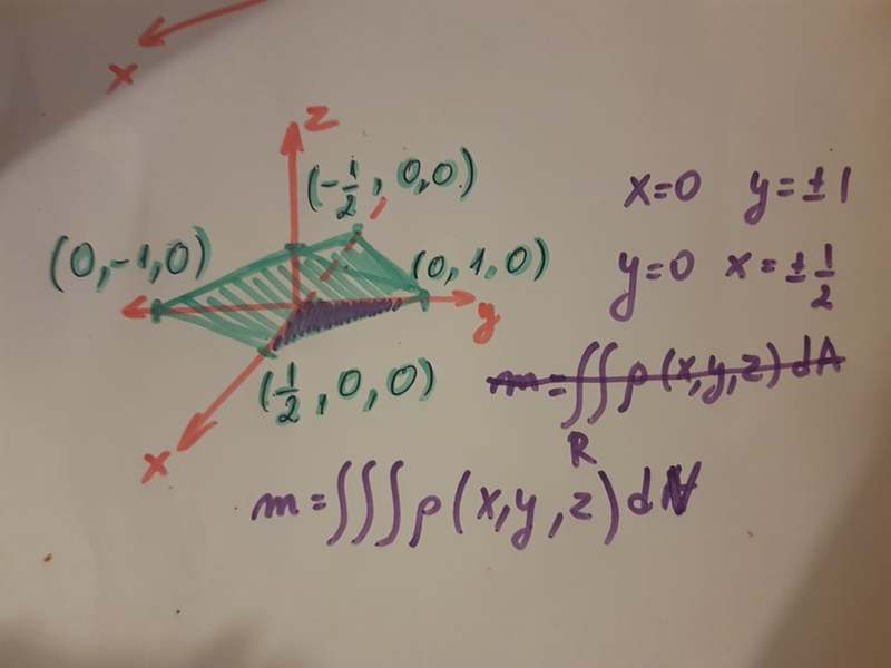

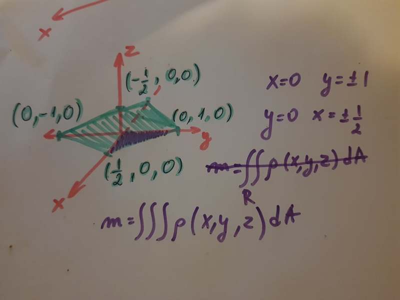

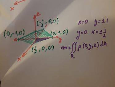

Handwritten 3D sketch of a tetrahedron-like region in x, y, z axes with vertices at (-1/2, 0, 0), (0, -1, 0), (0, 1, 0) and (0, 0, 1/2), shaded green with a purple triangle at the base; beside it are the lines x=0, y=±1, y=0, x=±1/2 and crossed-out and corrected mass integrals m = ∭ρ(x,y,z) dV.
I hope you can see the picture better now. I was wondering if I need the whole rectangle as a region or just the purple triangle that I sketched there?

I guess it is just the triangle, because we have
Two inequalities written in math: x ≥ 0, y ≥ 0
Handwritten notes on a whiteboard: at top, m = triple integral of rho(x, y, z) over a region; below, m = triple integral with limits 0 to 1, 0 to 1, 0 to 1/2 of (1 + z) dx dy dz; at bottom, m = with nothing after it.
Is my final equation ok?
Your sketch is nowhere close to being right. It is a three dimensional solid.
What is the range of z? For some arbitrary z in that range, what does the XY lamina look like?
