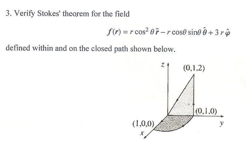

I just need to be able to change a vector field from spherical to cartesian
The question is about verifying stokes theorem (curl theorem) for a given vector field within and on a given path. It says not to use spherical coordinates, but the vector field is given in spherical coordinates.
I tried using the equations that relate r, theta, and phi to x, y, and z. One thing is, that it gets very messy, and I don't think it's meant to be. Another thing is that I don't know what to do with the unit vectors, as I have components that are (now) functions of x, y, and z but are pointing in the r, theta, and phi directions. I gather if I fixed that up, the messyness would disappear, but I don't know how to do it.
I also considered finding the curl in spherical coordinates and then using a Jacobian determinant to evaluate the integral, but I thought this might be kind of cheating.
If I can figure out how to change the vector field from spherical coordinates to cartesian I will have no trouble doing the integrals. I have a feeling I would've learned this in first or second year calculus, but I can't remember :( Any help would be appreciated.

It is actually problem 1.56 in griffiths "Introduction to electrodynamics", which in the solution manual is done in spherical coordinates, hence why we're not allowed to use them.
Here is the question
https://www.physicsforums.com/attachment.php?attachmentid=18133&stc=1&d=1237876170

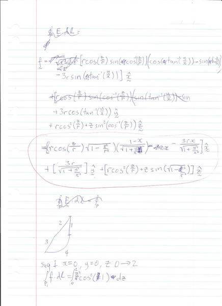

After this it says not to use spherical coordinates, but I didn't scan that.I have tried to calculate what the field is in cartesian coordinates, and after substituting the equations for the variable and the unit vectors, I cam up with this (the bit circled in red is the field that I calculated...sorry if the rests so messy. I thought I'd leave it into a t least show a little bit of how I got to the final bit.)
https://www.physicsforums.com/attachment.php?attachmentid=18132&stc=1&d=1237876170
Underneath you can see that I started calculating the line integral for what I labeled as segment 1. Then (I didn't scan this bit) I tried to do segment 2, but x is zero along segment 2, and there are two integrals for the second part, one for the y direction and one for z. In the y part, you can see that I end up needing to divide by zero when I set x=0.
I'm sure that it's not meant to be this complicated. I can't imagine how difficult it would be to get the curl the way I'm doing it.

Yet another edit: I am getting somewhere. I'm sure I can (and will need to) simplify it further, but now I have
[tex]-3y\sqrt{x^2+y^2+z^2/(x^2+y^2)}\hat{\textbf{x}}+3x\sqrt{x^2+y^2+z^2/(x^2+y^2)}\hat{\textbf{y}}+z\hat{\textbf{y}}[/tex]And for the grand finale...I've got the left hand side done and I know it's right because it agrees with the version in the book done in spherical coordinates. I should be okay from here. Thanks again for the help.
