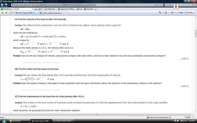

bc the initial velocity is 3.8 \hat{}ithe velocity after ten seconds is 4.08 m/s\hat{}i+ .46 m/s \hat{}j

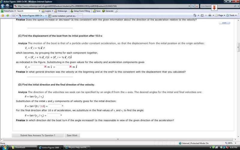

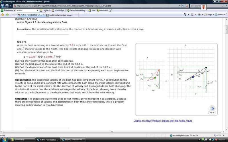

sorry this is such a big picture, but this is what i have to work with.

Jbright1406: So I'm guessing that your having trouble with part (c). Could you post your working?
im at the library an ddont have it on the comp. I am tryin to work it on paper but i think I am plugging it it wrong.
try this
(.23*10+.5*.023*10^2)ihat + (0.46*10+.5*.046*10^2)jhat
3.45 i hat + 6.9 jhat
try this
I'm note sure where your pulling those numbers from, but note that the values in red should be the initial velocity of the boat before the acceleration.
