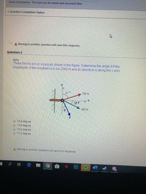

lwin
Can’t seems to find the "°"
Fx=Fcos”°”
Fy=Fsin”°”
Resultant = Squareroot(Sum of Fx)^2+(Sum of Fy)^2
Can’t seems to find the degree
According to the diagram, there are 3 forces acting. What should you to do with them to get the resultant force?
Hint: Try to setup a system of two equations with two unknowns.

Already did that

These 2 equations are "written on" x & y axises
y axis:
750 cos(41) = 390 sin(35) + p cos(θ)
x axis:
>>you write this similarly<<P.S.
you may need to know that:
if,
cos(θ) = k
Then,
θ = arccos(k)
y axis:
x axis:
if,
cos(θ) = k
Then,
θ = arccos(k)

@lwin, only now I noticed that it was your first post - welcome to PF!
One more hint for you: when solving the two equations for ##P## and ##\theta##, this equation might come handy:
$$\cos^2 \theta + \sin^2 \theta = 1$$
