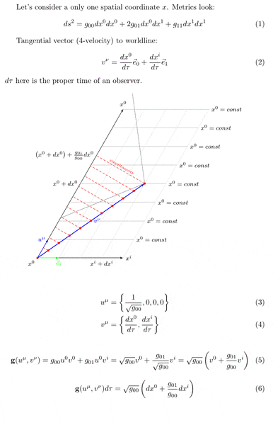

I thaught the velocity shoud be mesured by an observer at ##x^i = const## in terms of the proper time, determined by the observer's clock, but not with clocks synchronized along the trajectory of the particle! Who does measure the time by clocks synchronized along the trajectory of the particle!? An observer who moves with a particle?
Is it correct?
Velocity ##v## is measured in terms of the proper time of an observer, as determined by his clocks, but the clocks should be synchronized along the trajectory of the particle.
http://i95.fastpic.ru/big/2017/1030/23/dad89b2556464763fbacaaa601e59723.gif

Thank you for article.
I think every observer (ZAMO or other ones) measure (of course, locally) speed of light equal to 1, and thus, all measurements of the velocity should be division distance by proper time of an observer. That is my understanding of velocity.
The proper time equal to ##\sqrt{g_{00}}dx^0## in general metric, as well as for Schwarzschild case (where ##g_{0i} = 0##). But when the ##g_{0i} \neq 0##, for velocity measurements one should be divide distance by not proper time, but synchronized time of an observer, only in this case we can obtain physical reasonable result. Mathematically, the procedure of velocity measurement is a projection of particle 4-velocity on the observer 4-velocity, but it is not obvious for beginner level, I think. Now I try to find a way (using space-time diagrams) to explain for some imaginary student, why for velocity measurement we should be divide distance by synchronized time.
This works for locally measured velocity, so your position amounts to saying that the term "velocity" is properly used only to describe such local measurements of velocity (i.e., measurements carried out within a single local inertial frame, in which the laws of SR hold).
This does not seem to be consistent with what you said earlier in the same post (quoted above). Also, it's not clear what you mean by "synchronized time", how it is different from proper time, or why you think it must be used instead of proper time to obtain a "physically reasonable" result.
Which can only be done within a single local inertial frame, i.e., where the particle's worldline crosses the observer's worldline, so the 4-velocities can be directly compared. This is consistent with saying that "velocity" properly refers only to locally measured velocity. But it does not appear to be consistent with your statement about using "sychronized time".
What is "synchronized time" is from book of Landau (is a proper time, as determined by clocks
), I quoted the above in post #21
and I just do not understand why one need to divide by synchronized time, as Landau mentioned, but only this procedure leads to reasonable results.
