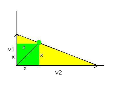

Three particles start moving simultaneously from a point on a horizontal smooth plane.
First particle moves with speed ##v_1## towards east, second particle moves towards north with speed ##v_2## and third one moves towards north east. The velocity of the third particle, so that three particles always lie on a straight line is,

See attachment. The two yellow triangles are similar. The green square have sides equal to both the x and y components of v3. What are the sides of the yellow triangles? What equation you get from the similarity?
ehild

Side of the square with $x_3$ as diagonal=a
$$a^2+a^2=x_3^2$$
$$2a^2=x_3^2$$
$$\sqrt{2a^2}=x_3$$
$$\sqrt{2}a=x_3$$
$$a=\frac{x_3}{\sqrt{2}}$$
$$Area of the square=$a^2$$
$$=\left(\frac{x_3}{\sqrt{2}}\right)^2$$
$$=\frac{x_3^2}{2}$$
Area of the triangle fromed by $x_1$ and $x_2$ - Area of the square=
Area of the triangle formed by 2 small triangles.
$$=\frac{x_1x_2}{2}-\frac{x_3}{\sqrt{2}}=$$
$$\frac{1}{2}\left(\frac{x_3}{\sqrt{2}}\right)\left(x_2+x_1-\frac{x_3}{\sqrt{2}}\right)$$.

Well, there are errors in the previous lines.
You forgot a square: the area of the little square is ##\frac{x_3^2}{2}##
The sides of the small triangles are x1-x3/√2 and x2-x3/√2, so you have to subtract x3/√2 twice.
The correct equation is
\frac{x_1x_2}{2}-\frac{x_3^2}{2}=\frac{1}{2}\left(\frac{x_3}{\sqrt{2}}\right)\left(x_2+x_1-2\frac{x_3}{\sqrt{2}}\right)It would have been simpler to equate the area of the big triangle and the sum of the other two, with bases x1 andx2 and hight x3/√2.
ehild

I get upto this. After this, I don't know where to go

Expand and simplify the equation
\frac{x_1x_2}{2}-\frac{x_3^2}{2}=\frac{1}{2}\left(\frac{x_3}{\sqrt{2}}\right)\left(x_2+x _1-2\frac{x_3}{\sqrt{2}}\right)
x32 cancels.
ehild

OH! I missed that x_3^2/2 cancles.
I will work out and see. I feel tired of typing long and complex latex. that's why I am not able to type all my work.
I found it!
<br /> <br /> \\<br /> \frac{x_1x_2}{2}-\frac{x_3^2}{2}=\frac{1}{2}\left ( \frac{x_3x_2}{\sqrt{2}} +\frac{x_3x_1}{\sqrt{2}} - \frac{2x_3^2}{2}\right ) \\<br /> <br /> \frac{x_1x_2}{2}-\frac{x_3^2}{2}= \frac{x_3x_2}{2\sqrt{2}} +\frac{x_3x_1}{2\sqrt{2}} - \frac{x_3^2}{2} \\<br /> <br /> \frac{x_1x_2}{2}=\frac{x_3\left(x_1+x_2 \right )}{2\sqrt{2}} \\<br /> <br /> \frac{2\sqrt{2}.x_1x_2}{2}=x_3\left(x_1+x_2 \right ) \\<br /> <br /> \sqrt{2}x_1x_2=x_3\left(x_1+x_2 \right ) \\<br /> <br /> x_3=\sqrt{2}\frac{x_1x_2}{x_1+x_2} \\<br /> <br /> v_3t=\sqrt{2}\frac{x_1x_2t^2}{\left( x_1+x_2\right )t}\\<br /> <br /> v_3=\sqrt{2}\frac{x_1x_2t^2}{\left( x_1+x_2\right )t^2}\\<br /> <br /> v_3=\sqrt{2}\frac{x_1x_2}{ x_1+x_2}<br />
##v_3=\sqrt{2}\frac{x_1x_2}{ x_1+x_2}##
Yes, but write v1,v2 instead of x1,x2.
