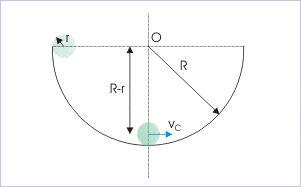

A ball of radius ro rolls on the inside of a track of radius Ro. If the ball starts from rest at the vertical edge of the track, what will be its speed when it reaches the lowest point of the track, rolling without slipping?
Included below is a link to the diagram:
http://s3.amazonaws.com/answer-board-image/0c73c3d19aaa1d4c316cd2e6d2da8e57.jpg

I think the diagram is a bit off, so draw your own. Imagine a circular ramp. The initial position is just where the wall is vertical, so a line drawn from the center of the circle to the sphere would be horizontal. Compare the initial and final height of the ball. (Measured from what point?)

That diagram doesn't seem to make sense. Where did you get it? Better to imagine a semicircular track that the ball is rolling down. Note that the starting point is where the wall is vertical, which is not at 135 degrees.
Also, why do I need the radius of the ball? I have it as part of the moment of inertia formula for the sphere but, other than that, I'm confused why I need it. Does it have something to do with the potential energy?
The "trick" is figure how the height of the center of the ball changes as it goes down the track. (Yes, that does affect the potential energy.)
Okay, well now I'm absolutely lost. If we assume the initial position of the ball to be 0, then the final height would be Rocos(45) because 135-90=45. We're changing quadrants that the ball is in so now the 135° angle is a 45° angle.
If I'm wrong, then I have absolutely no clue where to go next...
I found this image that might help:
Not perfect, but pretty close to what I imagine the problem to be discussing. Note the initial and final positions of the ball.

The initial height, Ro, measured from the lowest point of the track, is correct. That's the initial height of the ball's center.
The second height, Ro-ro, is not correct. Rethink that.
Oh, okay. So the second height is ro and I get the right answer... my question is how does that make sense?
If ro is the radius of the ball but the ball is already at the bottom of the ramp, then how could the radius of the ball be part of potential energy? In order to reduce the potential energy, you'd have to reduce the radius of the ball.
I understand how the math works out now but I'm confused as to the theory behind the math.
What's the height of the center of the ball initially?
What's the height of the center of the ball when it is at the bottom?
What matters to gravitational PE is how the ball's center of mass changes height.
Ah, I understand now. So it all comes down to what frame of reference we're looking at it from...
Many thanks for the help.
In this situation we have both linear kinetic energy and the rolling kinetic energy, so:
KR= 0,5.I.ω2 =0,5.2/5.m.r2. (v2/r2) =1/5.m.v2
and Klin=0,5.m.v2
we also have the potential energy: E=m.g.h
with h= R-r (we don't have to forget to subtract the radius of the ball to the ground)
lets use the equation of conservation of energy (because we have no friction):
0,5.m.v2 +1/5.m.v2=m.g.(R-r)
when simplifying this equation we get: v= √10/7.g.(R-r)
