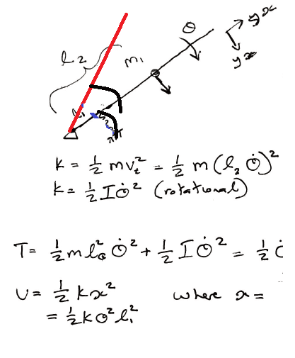

Hi Guys
Please refer to the attached document for my derivation.
The image presents the system in plan view, I know one my think that it is unstable structure based on a single pinned connection however this is a simplification of a complex structure sitting on a slew bearing.
Gravity does not play a part in this system. The rod essentially rotates with it's center of mass at l2, there is also a spring connected to the system which will impact into a wall. The system assumes that the spring and wall are already in contact.
Note that the D term is the damping of the system.
Is the approach I have used acceptable?
In the last line you posutulate that the spring shrinks keeping the shape of arc . Further,
U=\frac{1}{2}kl_1^2(\theta-\theta_0)^2
for
\theta-\theta_0 <0
otherwise 0 where ##l_1\theta_0## is natural length of arc shape spring.
