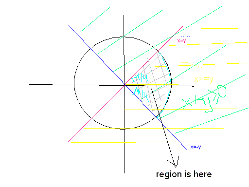

how do you explain why theta is from -pi/4 to pi/4
First draw the region given to you .
[tex](x^2 + y^2 \leq 1), (x + y \geq 0), (x - y \geq 0)[/tex]
The boundary of region is determined by the lines x=y, x=-y and the circle [tex]x^2+y^2\eq 1[/tex]
Circle gives you first limit [tex]0\leq r\leq 1[/tex]
and these two lines gives you limit for theta
(x=y and x=-y makes angle pi/4 w.r.t x-axis)
And by the inequalities you conclude theta should be between -pi/4 and pi/4
why the line integrals are as they are
They are the curves on which you will evaluate your line integral directly
If you did draw the region correctly
you will see (it is like a slice of a pizza) r1 r2 and r3 are the linesegmentsbounding the region
To be more clear
r1 is part of x-y=0
x=rcos(theta) y=r sin(theta) and you know theta =pi/4 and r changes from 0 to 1 (you can replace r by t anyway just notation)
The others are similar
r2 is part of x+y=0
r3 is part of the circle which is an arc from -pi/4 to pi/4 with radius 1
edit:region is drawn in the picture

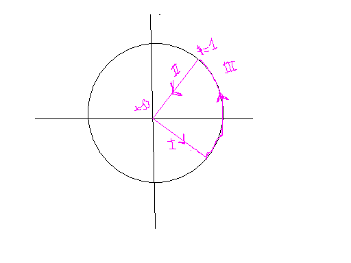

just checking
thanks for this one: from the information provided here is what i managed to work out:

(a) You did good computations and "computationaly"
your line integrals for r1 and r2 are correct .On the other hand you did mistake in the directions(please look at the attachment) .
For r2 : t does not go from 0 to 1 , it goes from 1 to 0 .
So just multiply by -1 to revert the direction of the integral
As a result sum of the line integrals of r1 and r2 not equal to zero
Conclusion= If you add them all , you get [tex]\frac{ \sqrt{2} }{3}[/tex]
