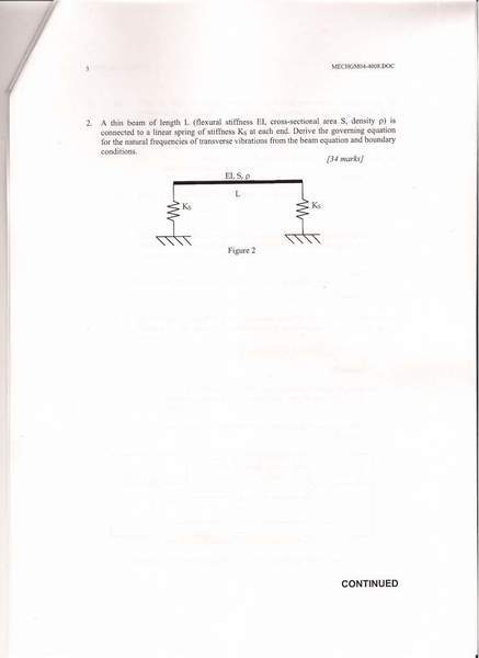

A thin beam of length L (flexural Stufness EI, cross-sectional area A, density p) is connected to a linear spring of stiffness K_s at each end. Derive the governing equation for the natural frequencies of transverse vibrations from the beam equation and boundary conditions
Not sure
I am really not sure how to start this one, can someone help please
Try to use
Flexural stiffness definition (EI=E*I/L),
Hooke's law (F=-kx)
Beam equation
[tex]\frac{\partial^2}{\partial x^2}\left(EI \frac{\partial^2 u}{\partial x^2}\right) = w[/tex]
, in the simple case
[tex]EI \frac{d^4 u}{d x^4} = w(x)[/tex]
See also http://en.wikipedia.org/wiki/Beam_equation
