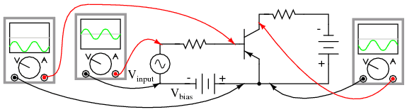

In Voltage divider bias ,
we are not drawing any electrons from the base.
Then how can the electron current pass through the base and go to the collector and reach the positive terminal.
Only if You draw electrons from the base by maintaining the base at positive potential,
then only the electrons from Vcc can flow through the base and to the collector and reach the positive terminal of Vcc.
The need for removal of electrons from the base is that.
In the first circuit shown,
when the base emitter is forward biased, the holes in the P region diffuse into the N region and the holes in the base are now filled by electrons as a result the base becomes the negatively charged. Now the electrons from Vcc negative terminal cannot pass through the transistor as they have to cross the base which is now negatively charged . But since the base is made positive the electrons that filled up the holes are attracted as a result the base now consists of holes and the electrons from - Vcc can now flow through the transistor .
Since in Voltage divider bias this provision( Vbb) is not there , then how can electrons be withdrawn from the base and how can current flow through the transistor.

Why do you think an amplifier set up with voltage divider bias will have no base current?

Ok fine. We'll go with electron flow. NOW WHY DO YOU THINK THERE IS NO CURRENT LEAVING THE BASE OF THE TRANSISTOR? I keep giving you a one liner because you refuse to answer the question that I have asked. Maybe I'm misunderstanding you. Is this question specific toward the way the transistor is configured in your first post or are you referring to transistors in general?
See attached image of NPN transistor. Electrons flow into emitter, and out through the base (into voltage divider) and out through the collector (through collector resistor) to Vcc.

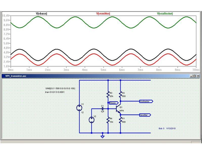

Sudar-
I am not trying to be arrogant. You need to understand basic dc electrical circuits; voltage sources (power supplies), volts, amps, and resistors. Then you need to understand basic solid state device concepts. In my case, I was educated when vacuum tubes were popular, and my understanding of cathodes, grids, plates, and space charge helped me understand npn transistors. Please review the voltage divider in my post #7. See
https://www.physicsforums.com/attachment.php?attachmentid=23038&d=1263409258
Electrons are flowing out of the base into a voltage divider. The positive base-emitter bias is causing electrons to flow from the emitter to the collector. This is very similar to electron currents flowing out of a hot vacuum tube cathode to the plate, and being controlled by the grid..
Bob S
