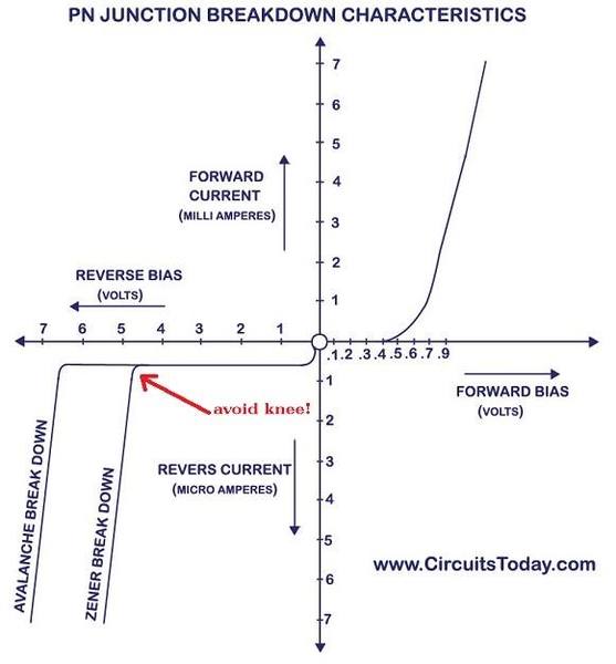

Thank you Dave, thank you Jim! I really appreciate your help, but can I ask you one more question : When talking about zener diodes, we can clearly see from the I-V curve that below the zener treshold voltage (when talking about the reverse characteristic) there is still some leakage, thermaly generated I guess, current. Then at treshold voltage because of zener breakdown we get a very rapid increase of the zener current. We get the minimum zener current Izk, the test zener current Izt and the maximum allowed zener current that will be able to pass without the diode to reach the avalanche breakdown which will burn it. And now it is said that in cases when you want to use the zener for a voltage regulator, you must chose the zener current to be greater than Izk, but smaller than Izm. Smaller than Izm because we don't want to damage it. And greater than Izk because it won't regulate good if it's below it. Now that last thing, that if the zener current is smaller than the minimum zener current it won't be able to regulate as good, I can't understand. I've tried whole day writing in different forums and such, searching youtube and google for answer, but it looks like those sources offer only basic information. And so I couldn't find out and I still don't know how if the zener current is lower than the minimum zener current it won't be able to regulate as good. Can you help me on this one too?
I am thinking, maybe its because of the internal ressistance each diode posseses. As the current decreaces and falls below Izk, less current through a constant ressistance means less voltage drop and so the zener voltage falls below the treshold voltage, thus messing with the output, causing it to be lesser.

it's because the zener (or avalanche) breakdown isn't a snap-action, it's somewhat gradual
Wikipedia actually does a decent job
https://en.wikipedia.org/wiki/Zener_diodebut i thought this guy had a better diagram
http://www.circuitstoday.com/pn-junction-breakdown-characteristics
and you should peruse his article.
you want to avoid that nonlinearity around the knee .
which might be under-emphasized even in this picture
think for a moment ...EDIT oops i see i reversed my words again
if you very slightly adjusted reverse current about some point, let's just say just a few microamps back and forth centered around a milliamp
and measured the resulting fluctuation in voltage up and down
errr,,, make that read
if you very slightly adjusted reverse current about some point, let's just say just a few microamps back and forth up and down centered around a milliamp
and measured the resulting fluctuation in voltage up and down back and forth
end edit
then divided Δvolts by Δamps, as we do in Ohm's law for DC
you'd get a "dynamic resistance" to AC at that point on the curve
and i trust it's obvious that'd be the slope of the curve at that point...

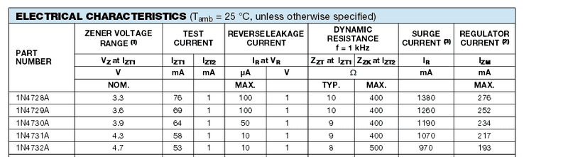

Now look at this datasheet
http://www.vishay.com/docs/85816/1n4728a.pdf
and note they tell you what is "dynamic resistance" at two different currents
1N4782 at 1 ma DC, would give you a change of up to 400 max microvolts per microamp change in the DC current
but at 76 ma DC, gives typically only about 10 microvolts per microamp change
The smaller the slope the better the regulation
but instead of "slope" they call it "Dynamic Resistance" (because that fits right in with 'small signal analysis' of circuits)
They're telling you it regulates a lot better away from the knee.
Hope it helps,
old jim

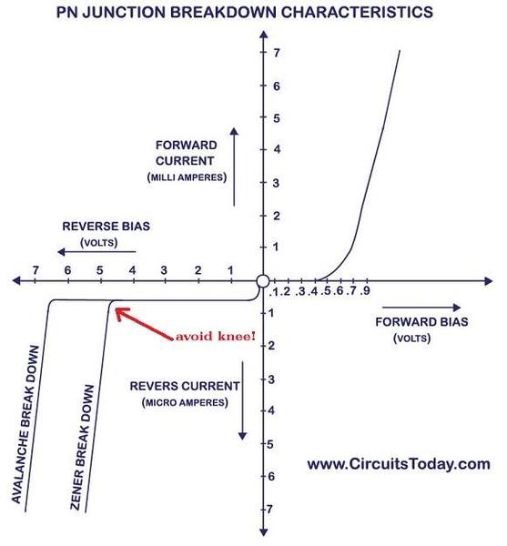

think for a moment

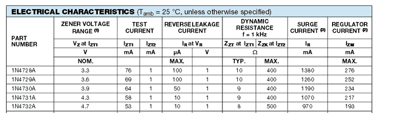

Hope it helps,
old jim
