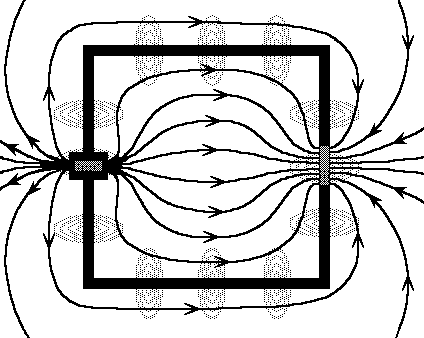

i have only conceived of the field as a 3dimensional radiation wave. that being so, i imagine it moves through the wire along with everywhere else.. but i thought the electrons themselves were the "wave" that transmitted the energy.
But you said that energy can be transmitted wirelessly through EM waves in space... think of the electrons being to the EM field as corks are to the surface of a pond. They bob up and down and drift about in response to the waves on the surface.
The electric field that is important to your understanding is the one applied to the length of the wire - the part of the field is not generated by the acceleration of the charges in the wire.

The power is in the form of near-field reactive EM fields that travel from the generator to the load in AC. Alternating Current is the effect of the fields on the electrons in the wiring as it moves, as the 'Power' is not in the electrons that restrain the fields near them. Yes, you don't have to deal with far-field wave propagation usually but you still have to deal with wave movement effects similar to umatched coax for RF transmission in long AC power lines that store large amounts of electrical energy in those fields.

We should bear in mind that everything depends on a context - it is possible to have small scale AC that is well modeled without the traveling wave. But if someone is having trouble figuring how something that is essetially a back-and-forth movement could be considered to be delivering something, pointing out that longitudinal traveling waves exist is a valid approach. Here you have a back-and-forth motion that does deliver things.
As sophiecentaur points out - in power transmission over long distances - the traveling EM wave is important. A lot of industrial standards have been adopted so that the working power co engineer does not have to think about it too much though. Engineers often go their whole careers not considering all kinds of things that are present and important to the physics. It one of the differences between engineering and physics: they are doing a different job.
It is true that engineers seldom need to understand traveling waves to do their job - but OP would benefit from knowing about them to achieve his stated aims. Feel free to disagree - I'm sure the parallel discussion will be useful.

Using wave and field theory to design a standard flashlight is crazy but an understanding at even the most simple level of the physics of electical power flow in fields from a battery to a bulb is something that seems to be getting lost in some basic electrical training courses.
Understanding the concept of field energy flow brings 3D geometry into circuit design and helps you visualize why systems interact in sometimes strange ways like how electrons (charge) travel slowly in a circle in the flashlight wiring but power only travels one way (from the battery to the lamp) on both sides of the circuit at almost light speed.
Diagram of electric and magnetic field lines around a rectangular loop of wire, with a battery on the left and a lamp on the right, showing field lines flowing from the battery to the lamp outside the wire.
