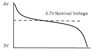

I bought a lithium-ion battery rated at 3.7v.
I charge it with my existing phone charger rated for 3.7v batteries and charging at 4.2V.
i like to know why are batteries are rated like this. That is, a 3.7V rated battery is actually charged to 4.1 or 4.2 when its considered 100% fully charged. So, why is it not rated at 4.2v?
Why the misrepresentation? Of course, I am assuming there is misrepresentation.
And yes, I understand that you need a higher voltage to charge to a voltage that is near but lower than that voltage. So my question is on the choice of the rating and not the reason for using higher voltage to charge a battery rated lower.
Thank you for reading.
Best regards
Pascal
Constant current discharge curve for a Li-Ion cell:
It's understood within the industry that all battery chemistries have their own discharge curve. They also have idiosyncrasies regarding their needs during charging and discharging.
With the exception of reference cells, batteries are not intended to hold a constant voltage - their intended to maximize their performance at supply energy or power.

Also - from a ratings perspective, we use batteries for energy, not just supply a voltage, so the Nominal Voltage combined with the Rated mAh = total energy that the battery is rated for.
As for the charger - the phone or battery module itself, may have a V and I regulator integrated - and is rated for 5V input ( notice this is also the USB voltage - so most cell phones are prepared for 5V - and regulate themselves) . Overcharging these is a problem ( hazard) and they put some effort into this aspect of the design.
