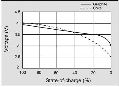

A "fully charged" NMC battery has to have 4.2 volts applied to it, but should deliver a "nominal voltage" of 3.6 plus or minus 0.5 volts. That just means that over the discharge cycle the voltage should be about 3.6 volts on average, but in reality it will usually be more or less depending on where in the discharge cycle the battery is at. If you only charged the battery using 3.6 volts the battery would have less capacity and output at a lower average voltage during the discharge cycle. If we think of 4.0 volts as being "fully charged" then the battery should behave approximately like the graph below (solid line).

Looks like when a nominal voltage of 3.6V is stated, that means that is close to dead, and is probably how it is shipped. If charged to 4.2 volts, its remaining amps are almost over at 3.7volts. If charged to 4.0 volts, its remaining amps are gone near 3.3 volts. Charging to 4.0 volts is suggested for max cycles.
I'm not sure how you're getting your numbers. It appears, at least to me, that at 3.6 volts your graph shows that you have approximately half of the battery capacity left if you're discharging it at 3c. If you're discharging it at 0.2c, then you'd have less than 10% capacity left. This means that discharging at a slow rate allows you to maintain a higher output voltage compared to discharging at a faster rate. See here for an explanation of c rates: http://batteryuniversity.com/learn/article/what_is_the_c_rate
Note that the discharge voltage itself varies with the current. A higher current decreases the output voltage because the batteries internal resistance has more of an effect when the resistance of the circuit is lower (hence why the current through it is higher).
