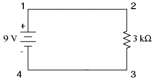

If I had a simple series circuit with only a single resistor, and I used a voltmeter to find the voltage between a point at the end of the circuit and another point, which was moved from the beginning to the end of the circuit, what would I find at these various point?
Would the voltage remain the same as the points got closer, or would it change?

Yes there’s a power supply. Here’s a picture of something like what I’m thinking of.
My intuition from having used a voltmeter before is that it would be the same everywhere. Although of my intuition is correct, I’m left a bit confused.

If you put the voltmeter leads at points 1 and 2, it will show zero volts if the wire is idea with zero resistance.
If the wire has nonzero resistance, there will be a slight voltage V12. it would get smaller as you bring the two leads closer to each other. However, the slight voltage may be only a few microvolts, too small for you to measure with an inexpensive meter. Your picture shows the voltage of the battery and the ohms of the resistor, but it does not specify how thick the wires are. The thinner the wires, the more resistance they have.
In circuit analysis, we typically assume that all wires have zero resistance even if that is not strictly true.

It's good you posted a picture. I have two more questions:
What do you think your voltage meter will show when you measure between...
  1. ...point 1 and 2 in your picture?
  2. ...point 2 and 3 in your picture?

I want to say that it will measure 9v for question 2.
My intuition along with the responses make me think that voltage is only found between resistive parts of a circuit.

Now we have just got two more questions left:
3. ...point 3 and 4 ?
4. ...point 4 and 1 ?

I believe 0 for question 3 and 9v for question 4.
Correct!
