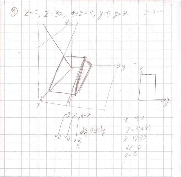

Set up but do not evaluate a triple iterated integral to evaluate,
[tex]\int \int \int_{V} dV[/tex]
where B is a region in [tex]R^{3}[/tex] bounded by the planes,
[tex]z=0, z=3x, x+z =4, y=0, y=2.[/tex]
I'm just curious to see if what I've come up with as an answer is correct or not.
Can somebody please quickly check my answer?
Thanks again!
  • Handwritten solution sketch for a triple integral volume problem: a 3D wedge region drawn with x, y, z axes, a small cross-section rectangle labeled z and y, the integral from y=0 to 2, z=0 to 3, x from z/3 to 4-z, and handwritten equations x = 4 - z, z = 3(4 - z), 4z = 12, z = 3.
Looks ok to me. You can check your answer by just calculating the volume of that prism (1/2 bh)2=12
