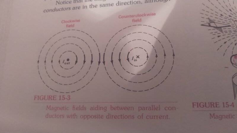

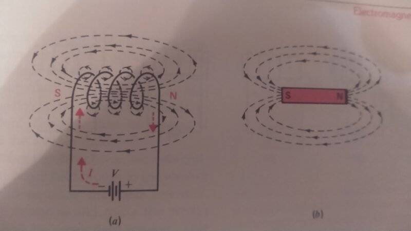

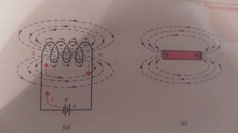

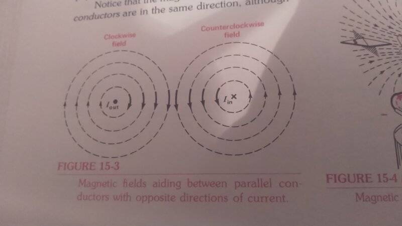

Ok. Let's try again. The flux, lines of force, whatever you want to call them, I know what they are, I have for many years, didn't think I'd have to post a pic to show it.
Ok. The dotted lines coming out of the right side of the coil (N) that curve around and go back into the left side I call flux. As the current increases, more of these lines are present and they 'bloom' outward away from the coil and inward towards the center of the bore inside the coil. Every line that is outside the coil must also be crammed into the inside of the coil. As the current in the coil decreases the opposite happens. I'm sure you agree with this. It's very obvious that a single loop of wire wrapped around the coil inside or outside will get 'cut' by these lines. The closer to the coil it is placed, the tighter the coupling will be.
Now flip that whole thing so we are looking down at it as the experiments we have been discussing have been displayed. No change really, just a more familiar perspective.
The infamous radial leads in the @mabilde experiment NEVER are cut by the flux. They are in the field but the flux lines while going in and out are not cutting them at right angles like they are the loop arc. So, the pie angle is certainly represented by the voltage measured here. Slide the contacts so the angle gets bigger and the voltage increases. Slide them all the way around so they are in contact with the single resistor and you get the same voltage as if you had twisted pair voltmeter leads coming from the resistor on the outside of the loop. This is one way that proves only the arc voltage is being measured and it isn't that a pickup loop is being formed by the pie shape.
The second way that proves this in the @mabilde experiment he used a shorted loop instead of the resistor. No voltage was ever read no matter where he positioned the pie shaped leads. There's no reason to believe that there was any kind of canceling effect occurring here. The fact that the pie shaped leads didn't give a reading here should prove that the radial leads are immune to contributing to a reading one way or the other. Measuring from the center is the ONLY way to measure a voltage between points on the ring accurately.

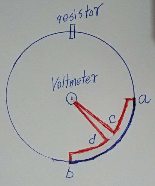

  • #146
tedward said:

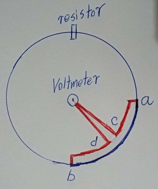

I don't see how the static potential would 'redistribute' to c-d, wouldn't the potential values match exactly to the blue wire section?
## \text {Because}~~PD_{ab}=PD_{ac}+PD_{cd}+PD_{db} ~ ,~ PD{cd} = PD_{ab}- PD_{ac}-PD_{db}##
##\text{where PD = Potential Difference}##
##Since ~~PD_{ab}, PD_{ac},PD_{db}~~ \text {are known,}~ PD{cd}~~ \text {can be determined.}##
tedward said:
Though I'm not sure how it matters anyway
Since the electric field in the space outside the ring circuit is composed of the induced electric field and the electric field generated by the charge, if you want to predict, calculate and simulate the total electric field in the external space, you must know the electrostatic potential generated by the charge, and then you can calculate the electrostatic field from this electrostatic potential. If you only care the physical phenomenon inside the loop wire and the series resister, capacitor, and inductor, you may not need to pay attention to this electrostatic potential.
tedward said:
Voltmeters can't measure scalar potential in general because they can't separate the two effects
As mentioned earlier, the voltmeter is not completely unable to measure this electrostatic potential, sometimes it can be measured directly, such as the output of the transformer we usually use, and the setting of Mabilde. As for the total electric field in the outer space of the ring circuit, I think we can try to measure it with some advanced non-contact techniques like Scanning Electron Microscope (SEM)

View attachment 322284View attachment 322285
I'm trying to see what you're seeing but I can't. Yeah, those look like correct pictures of a magnetic field of a solenoid. But for the life of me I can't understand what this notion of 'cutting' is. Violin bowing again? So It's the magnetic field lines themselves 'cutting' across the wire that generate the emf? You make no mention of the induced electric field in the loop, where's that? I'm sorry, you're whole conception of this problem is different from mine, we're not going to agree on anything. I tried.

If the current in the coil increases, then the number of field lines increase. I think you saying that the field lines also move ("bloom outward") as the current increases, and the movement is radially outward.
Consider a pie-shaped loop inside the field region:
I interpret your description as saying that no voltage is generated in the straight sections because the field lines move parallel to these sections. The field lines do not "cut across" the straight sections. However, the field lines do cut across the arc section. So, you are arguing that voltage is generated only in the arc.
Is this at least somewhat along your line of thinking?

@TSny I could have been more clear. The lines bloom out on the outside of the coil. But they bloom IN towards the center of the bore on the inside of the coil. I'm not sure if the phrase bloom in is the wisest choice of words. Lol. The fact is that all of the flux lines originate AT the wires. Current increases and they move away from the wires.
