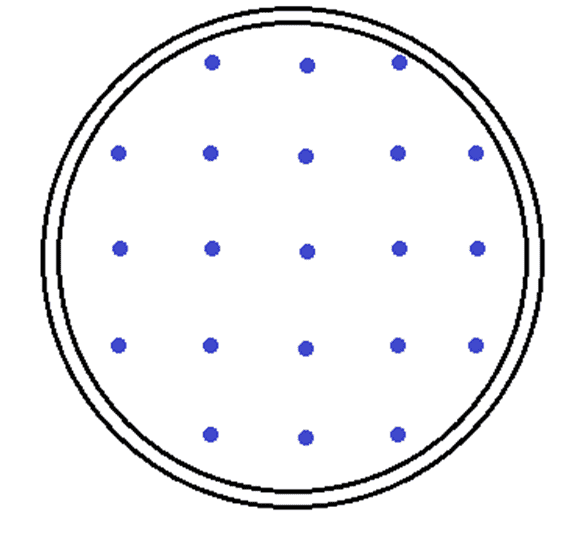

  • #151
Averagesupernova said:
@TSny I could have been more clear. The lines bloom out on the outside of the coil. But they bloom IN towards the center of the bore on the inside of the coil. I'm not sure if the phrase bloom in is the wisest choice of words. Lol. The fact is that all of the flux lines originate AT the wires. Current increases and they move away from the wires.
I see. So my arrows should have pointed radially inward for the case where the current is increasing. If the coil is a long solenoid, then the field at any instant of time should be approximately uniform over the cross-section of the solenoid. Suppose the current increases linearly with time so that the field lines move inward as new lines are created at the source current. It seems to me that the lines would quickly get very crowded together near the axis of the solenoid and I have a hard time visualizing how the field could remain uniform across the cross-section as the current increases. Anyway, I don't want to get into the middle of this. I was just trying to visualize your description of what's going on and understand why you are saying that voltage is only generated in the arc portion of the pie-shaped loop. Thanks.
Edit: Add picture with field lines moving inward

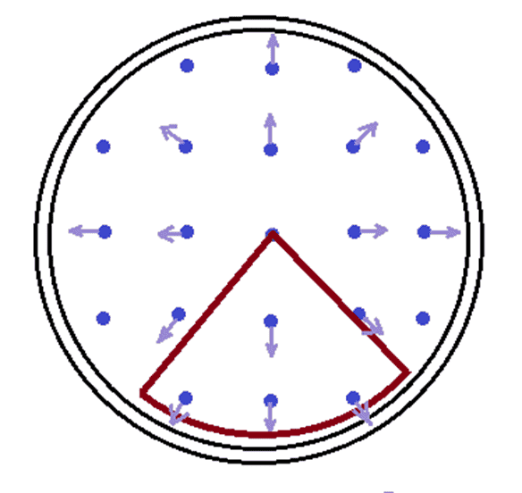

  • #155
TSny said:
Suppose the magnetic field of the coil is coming out of the page inside the coil:
Consider a pie-shaped loop inside the field region:
View attachment 322309Is this at least somewhat along your line of thinking?
This is a much better illustration of what's going on - flux is the amount of field that passes through any defined area. Whether the field lines 'bloom' in or out a bit towards the ring is irrelevant. The integral that defines flux (below) only counts the part of the magnetic field ##\vec B## that is perpendicular to the area - that's what the 'dot product' in between the vectors means. The part that points radially doesn't contribute anything.
$$\Phi_B = \iint \vec B \cdot d \vec A$$
But to really see what's going on, you need to see the induced field. I'll put up a diagram if I an find a good one

Here are the examples I was thinking about. We have flexible resistor wire (12 ohms) in series with conducting wire with zero resistance. In all the cases, total emf, total resistance, and current are the same. The path voltage ##V## is what the voltmeter measures with a flux-free loop (and of course corresponds to the true heat dissipation using ##P=IV##. Measured across the resistor path, it reads 12 V in each case. But since the induced voltage ##V_i## depends on the orientation of the resistor relative to induced electric field (i.e. to the solenoid), the scalar potential ##V_s## changes accordingly, as ##V_s = V - V_i##
The point that I'm arguing is not that you can't use the scalar potential, you absolutely can if it suits your purposes. But it's a specific convention that you learn in order to define a potential, it doesn't correspond to the true (net) electric field. I don't think most people who are arguing about what the voltage adds up to are really using this convention. I think they just see Mabilde's analysis and say 'well that makes sense to me.' I think if you showed them examples like this most people would take the path voltage as the convention that actually makes sense to them, and that's the one that Lewin uses which is path dependent.
If path dependency is a problem for people, they would likely have convulsions to learn that the 'voltage' across a resistor now depends on how you position it.
