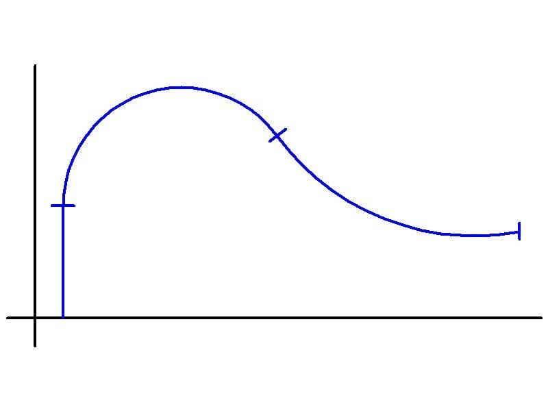

I am to design a 600mL water bottle by drawing one side (bottle lying horizontally). Three types of functions must be included (different orders). The cross-sectional view would be centred about the x-axis, and the y-axis would represent the radius of that particular section. There are meant to be no gaps and a "smooth transition between curves must be present.
All they have given us is V=πr^2
and V=π∫y^2 dx.
[/B]
I don't know even know where to start.
You are going to need to do some trial and error with some polynomials. At the transition points, the function values and their derivatives must match to make the smoth transition. The volume integral should wind up equal 600. Remember that mL is the same as cm^3

Here's another suggestion, assuming you aren't stuck with polynomials. Even if you are, it might give you some idea how to approach the problem. Consider the figure below:
Say each square is of side length ##h##. You can scale and translate a cosine curve to make the upper left smooth curve and a quarter circle to make the upper right curve. Once you have the equations of the upper half, calculate the volume of rotation. Then choose ##h## to make it come out ##600##. I'm thinking something like Maple would be very helpful. Good luck.

@LCKurtz Similar idea to yours .
Having one horizontal line segment makes the rest of the construction relatively easy .
I don't think there is any problem scaling the functions to get the correct volume .

Heh heh. But I want my jug to be able to sit on the counter and hold my beer. :smile:
Here you are - a flat bottom jug for you .

I guess one could argue that the vertical line is not really need to be one of the 3 (there is no dx to integrate). As long as the derivative at that point matches a vertical line... And did they mean you must use exactly 3 functions, or at least 3?
