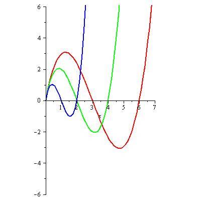

You haven't shown us anything about your design or how you came up with the equations that you want to scale. So I am going to give you one more example of how you might approach your problem. You are probably familiar with a typical cubic, such as one that has roots at ##x=0,~1,~2## whose equation would be given by ##y =A(x)(x-1)(x-2)##. The graph has a couple of arches. The constant ##A## determines the sign and how tall the arches are. So for my example, I'm going to say you want a cubic like that, with zeroes equally spaced, the first zero at ##x=0##, the others positive and equally spaced, and each arch height ##h## at its midpoint (this isn't quite the max point). And you want it to be scalable so it looks the same regardless of its size. Now, to get the zeroes equally spaced to make it scalable let's put the zeroes at ##0, ~h,~ 2h##. So the equation would look like this so far: ##y=Ax(x-h)(x-2h)##. Now, if we want the first arch to be positive and be equal to the width of the arches, we need ##y = h## when ##x = \frac h 2##. So let's put that in the equation for ##y## given above to determine ##A##. This gives$$
h = A\frac h 2 (\frac h 2 - h)(\frac h 2 -2h) = A(\frac h 2)(-\frac h 2)(-\frac {3h} 2) = \frac 3 8 Ah^3$$
This gives ##A=\frac 8 {3h^2}## and our final scalable equation for ##y## is$$
y = \frac 8 {3h^2}(x)(x-h)(x-2h)$$Now you have everything scalable in terms of ##h##. Below is a graph showing what the cubics look like for ##h=1,~ h=2,~ h= 3##. Three different equations, three different sizes, but the same shape.
Graph of three cubic curves on x and y axes from 0 to 7, shown in blue, green and red, each with two arches and zeros at increasing x values.
[Edit:] Apparently the general case is pretty easy. If you have an equation ##f(x,y) = 0## and you want to resize its graph by a factor of ##k##, just use ##f(\frac x k,\frac y k)=0##.
