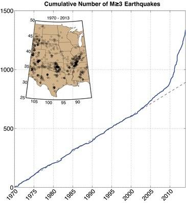

Whatever you "blame", something has clearly changed, from a statistical analysis:
From http://www.usgs.gov/blogs/features/usgs_top_story/man-made-earthquakes/:
Line graph titled Cumulative Number of M≥3 Earthquakes, rising from 0 in 1970 to about 1300 by 2013, with a steeper climb after 2005 and a dashed trend line. Inset map of the central United States shows circles marking 1970-2013 earthquake locations.
Cumulative count of earthquakes with a magnitude ≥ 3.0 in the central and eastern United States,1970-2013. The dashed line corresponds to the long-term rate of 20.2 earthquakes per year, with an increase in the rate of earthquake events starting around 2009.
From http://www.sciencemag.org/content/341/6142/1225942 it seems nobody even knows what is being done, at the right level of detail to do any modeling:
The current regulatory frameworks for wastewater disposal wells were designed to protect potable water sources from contamination and do not address seismic safety. One consequence is that both the quantity and timeliness of information on injection volumes and pressures reported to regulatory agencies are far from ideal for managing earthquake risk from injection activities.

There is no doubt that fluid injection induces seismicity
You only need to ask my fellow seiosmo guys. They can tell you when the injection processes start and stop by watching the coming and going of recorded events
The real worry is if a significant event is induced, say an M5+
M0 - M3's can be lived with, bigger ones could cause damage.
