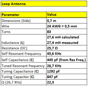

You are correct. I used to design/make bear beacons, arrow beacons and Rocket beacons and VLF nav was my 1st design for global Doppler. I hadn't considered the sender orientation and depth for null tracking. But I did find a representative VLF square loop antenna.
That seems to be one appropriate design. The multi-turn loop can be any polygon or circle, but the loop should be in a metal conduit that does NOT close to form a shorted turn. The conduit forms an electrostatic screen, so detection is of the magnetic field, not the electric field.
The orientation of the under-rubble transmitter can be random. It is the orientation of the RX loop that makes 3D VLF position finding possible.
Here is one strategy. First walk around the heap, looking for somewhere safe with a good signal on the surface. Then orient the plane of the RX loop to be vertical, and turn to find the null bearing. You have then identified a vertical plane that contains the TX. Then hold the loop plane horizontal and tilt it along that earlier bearing, to find the dip angle for the null of the TX signal. That gives the intersection of two planes, defining a line, that passes through the TX.
Next, move to another good signal position on the other side of the heap, and repeat the process. That gives you the intersection of two lines, and so an estimate of the TX's 3D position, and an error estimate based on the closest separation of the two lines underground.
