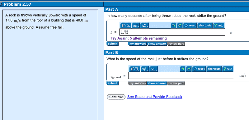

What am I doing wrong in this basic Projectile Motion Problem??
What I did in was use Delta X = Vxi + axt^2 & Delta Y= Vxi + ayt^2
then I plugged in the information but acceleration for x was 0m/s^2 and acceleration for y was -9.80m/s^2.

I don't know whether this is the only thing you are doing wrong, but it does seem like there are a few errors with your equations. It should be:
Δx = vxit + (1/2)axt2
The parts you were missing are shown in bold.

The stone was thrown vertically upward. If Δx means horizontal displacement, the initial horizontal velocity is zero, the horizontal acceleration is zero, is Δx different from zero?
You need to work only with ΔY=Vyit + ay/2* t^2. ay = -9.8 m/s^2, that is correct. What is the initial velocity? What is ΔY when the stone strikes the ground?
