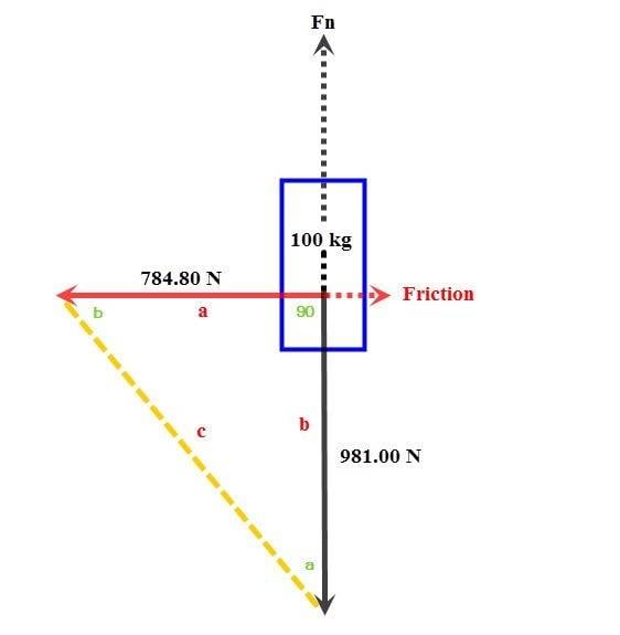

I am a truck driver, the law requires me to restrain my load of 100kg, to resist a forward braking force (deceleration) of 0.8g.
If, I took the 100kg load and tilted it (inclined plane), what angle of tilt, would be required to represent a force of 0.8g ?
How does one calculate the angle required to equate to a force of 0.8g, I happen to know the answer is 53 degrees, but, I need to know how this is calculated.
I am a real truck driver with a real problem and look forward to your solution.
Units are important here. After looking at the values on the diagram, I would say that if you want to work with SI units, then the force is really ##80g## Newtons, not ##0.8g## Newtons.
Now that everything is in SI units:
If you're on an inclined plane, your weight could be split into two components (using trigonometry): one parallel to the plane and the other perpendicular to the plane. We only care about whatever happens parallel to the plane for now. Given this information, do you now understand how the angle is obtained?

Yes, this is my working -
