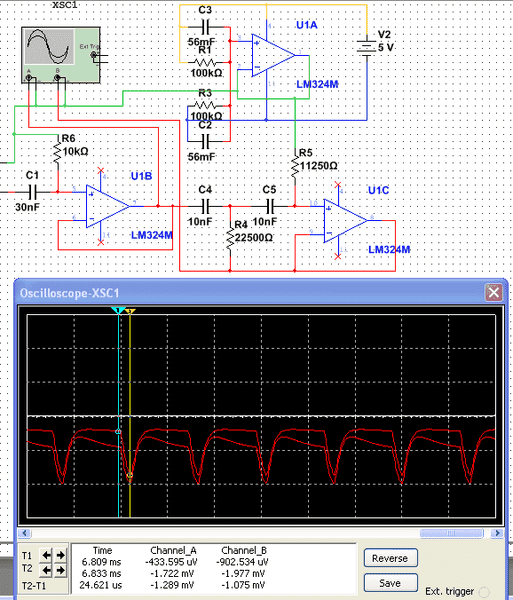

I was thinking of two 555-based monostables, holding unstable state for 50us, one having inverted input. And connect output from each to the reset on the other. First edge would then trigger one of the 555's, which pulls the reset on the other 555. The second edge would trigger the second 555, but it will be ignored because the reset is held. Third edge would then bring the trigger signal back to 0 and not make any change as the first 555 had not timed out yet. Then the first 555 would time out and it's ready for next pulse in any direction... it all sounded so well, so I tried with the attached schematic. Output from U4 and U5 would trigger each of the 555's.
To make it work with small signals I had to include U3 to amplify the input.
So the circuit is:
U1: input high impedance buffer
U3: input amplifier
U2: differentiator
U4/U5: (inverting) amplifier (555 input will require at least 800mV from vGND to trigger.)
This seemed to give a reasonable signal to the 555's, when input signal was weak (the lower graphic). However, when the input was stronger, clipping occurred. The clipping itself doesn't matter, but the 3rd edge is so late that the reset is released before the signal gets below trigger level of the 555's.
If I increase the 555 timeout to more than 50% of the cycle, I see a risk that it will trigger on 2nd edge, and ignore 1st edge on the next cycle.

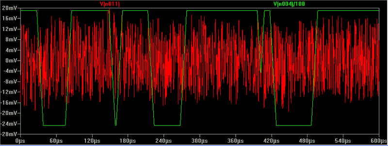

I haven't kept up completely, So I am not sure what the blue and green "smooth" signal are and where they came from in the circuit. Are blue and green the two possible inputs, and the smooth signal is the filtered possible outputs? I'm also not sure to what extent these two signals represent ideal or worst case levels.
Can you summarize it for me, and maybe I can think of a cool way to detect them.
  • #38
Blue / green is the output from U4 / U5.
The upper graphic is when input has the highest expected amplitude (both pulse and slow sine)
The lower graphic is when input has the lowest expected amplitude (both pulse and slow sine)
Outside the picture, on the left is a function generator and a transformer. From input signal passes through a high impedance buffer (U1), is amplified (U3), passes through the differentiator (U2) and is amplified again so that even the weakest expected signal will be strong enough to trigger a monostable based on a 555.
I'm currently reading up on automatic gain control with the intention to reduce gain in one or both amplifier stages. So far I'm leaning more towards just amplify the input signal, feed it to mpu and do the rest digitally. (= I'm about to give up analog processing.)

One more question. Relative to the Blue signal, what it is you want to detect (I sort of lost track of the original + and - pulses)?
MPU need to work with the following 3 states:
Pulses is positive
Pulses is negative
No pulses (no signal or signal to weak to be detected)
Edit:
Relative to the graphics, a pulse starting on T=0. I want to detect a pulse and it's direction. Delay doesn't matter. So I want to detect the cycles of blue or green, and I need to know which of them to pay attention to. As I pictured above, using the blue and green to trigger one 555 each. And say the 555 has a hold time of 50% of a cycle. The 555's will trigger when input is below Vcc/3. That is 5V/3 = 1.667V. Vgnd = 2.5V. Hence the 555 will trigger when signal is more than 1.667V-2.5V=-0.833V.
So, considering the weak signal graphed above, the timeline looks like this:

An outline of the way I'd approach this. I'd look at using a PLL chip to regenerate that 5kHz clocking signal (or at least a squarewave synchronous with it). Because each transition of that timing squarewave co-incides with the pulse position, sample your analog signal at that time using a sample-and-hold. Compare the amplitude of that sample with the analog signal a moment later, just beyond the pulse position. From their relative amplitudes deduce the polarity of that pulse.
EDITED
  • #51
Can you post a picture of positive pulses followed by negative pulses at the min and max levels.
Unlikely possibility 1:
It seems like you can trigger on the rising edge of both, which effectively becomes the leading edge of the positive pulse and the training edge of the negative pulse. Like putting a comparator at 0.4V and using it to fire the 1 shot. I expect when positive follows negative and vice versa it won't be so clean though.
Possibility 2:
At open loop gain op-amps make good (although slow) comparators. Use +- 0.8 volts as the references and deal with the "digital" output of the final two opamps.
Make a "short pulse" detector. If a positive pulse fires timer1, it enables a gate to fire timer2 if the pulse drops before timer1 times out. Do the same thing with the negative side.
Did that make sense?
BTW, using an ADC and figuring it out in the MPU is a good idea if you have the cycles.
  • #52
EDITED
I don't think I fully understood your idea. Regenerating signal will be easy. In order to have any further use of it it has to be in sync. Making sync will require signal amplitude within a certain range from the original signal. Wouldn't that just be a new angle to run into the same issue?

  • #60
Post 16:
petterg said:
Attached is my highpass approach.
Input is wires coming in from the left.
U1A is virtual ground generator.
U1B is an impedance buffer, having a DC block before it.
U1C and the RC's in front of it is the highpass filter.
Ch.A on the scoop is output from U1B. It's almost flat between the pulses. Voltage in the pulse max is about 4 times the level of voltage between the pulses.
Ch.B is output from U1C. It's starting to look more like sawtooth. Voltage in the pulse max is only about double the level of voltage between the pulses. And the voltage between the pulses are stronger than before the filter. So I've managed to get only the negative effects of the filter, none of the positive ones.
That's why I don't think highpass is the way to go.
Next up is lowpass + comparator.
Do you see why it's not doing any good?
No.
1. Are we really dealing with one millivolt of signal?
2. What's wrong with ch A ? Looks to me like it makes whatever is the input signal into negative going pulses.
