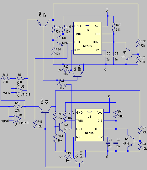

I'm having an issue with the 555's. The issue is that the timer starts when trigger goes low, even when reset is low. The result is that if reset goes high before the time runs out, the output goes high. Then problem also occurs if reset is high while trigger goes low, then when reset goes low output goes low, but if reset goes high before the timeout initiated by the trigger before reset, the output will again go high until timeout.
Is there a way to make reset include the discharge and not allow retrigger until next trigger edge?
With that issues solved, I think the oneshot approach will work.
Edit:
Alternatively the timer needs to be retriggered as long as the trigger input is lower than trigger threshold.
Reason is that pulse width may be long when input is strong, and timeout that is more than 50% of a cycle may cause other problems. Timer at 130-140us will work when cycle is exact 200us. Anything outside those 10us will fail. As this is supposed to work in the real world I have to account for some variance. A timer window of 10us is to small. By solving the retrigger, or reset including discharge (or preferably both) the timerrange may be in the range 70-140us. That will be a lot safer.

Your description of 555 behavior doesn't sound right. Is this a real one or a simulated one?
Tie RESET high.
Make sure you have bypass capacitors across supply, and on CTRL pin.
Tie TRIG and THRESH together, call them INPUT.
Check that it works like a simple inverter: INPUT LOW = Out(and Discharge) HIGH

It's simulation. I'm not building any real circuit before I've got it working in simulation. Datasheet doesn't say anything about how long the reset must be held low to reset. Simulation indicates that it must be held for whatever time is left of the timeout.
Simulation with TRG connected to THR behaves like you say. Also, if INPUT is low, output follows RST.
Problem is (I think) that DIS doesn't lead any current as long as TRG is low, no matter the position
of RST. To make it work there would need to be some sort of external discharge that is triggered when RST goes low. A transistor to short the timing capacitor has some effect, but it doesn't fully discharge. The other option would be a circuit to rapidly charge the capacitor (above THR) when RST is low.

I found this notice in the datasheet for NE555
http://pdf1.alldatasheet.com/datash...3_85UORlHDyRHOIpa/1XXyxeocTlLM+/datasheet.pdf
Applying a negative pulse simultaneously
to the reset terminal (pin 4) and the trigger terminal
(pin 2) during the timing cycle discharges the externalcapacitorand
causes the cycle to start over.The
timing cycle now starts on the positive edge of the
reset pulse.
That is exactly what I experience. All thou it could be written more precise, that the timing cycle starts on negative edge of trigger, so what the notice say occur if reset is released before timeout. And it doesn't matter if the reset and trigger pulses come at the same time or with some delay. While reset is low output is low. While reset is high, output will be high within the timing period. If there is a negative pulse to reset fully within the timing period the output will go low while reset is low, and return to high after the reset pulse. Timing period will start on negative edge og trigger even while reset is low.
Is that behavior unique for NE555 as I don't see anything similar in lm555 datasheet.
Buying a lm555 that is not a ne555 may be a challenge...

I kind of need level triggered. Or edge triggered output, level retriggered timer.
As I don't see anything similar to the notice quoted above, I can assume that behavior does not apply to 74123?

Might an edge triggered D flip-flop with clipped pulse for data and differentiated one for clock do it ?
It's immaterial which edge you use, the key is what follows an edge of given direction(up or down) tells you whether the transition was toward or away from zero.
Draw it out on a napkin.
