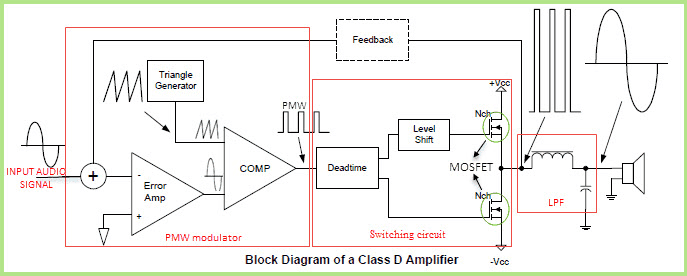

Check out "Class D amplifiers" and study the modulating stage:

ok I also thought about PWM, but I didn't pay much attention to it because I don't know about components. so if with this circuit I can through my smartphone select an audio track and send it to the circuit via cable, so that this audio track can be transformed into pulses in RF. as for the power it must be about 240 mW / cm ^ 2 and a frequency of 1 GHZ, with this circuit can I do this? Thanks in advance
my project envisaged as a pulse generator to use the NE555 chip, with this circuit you indicated to me, is it the same ??

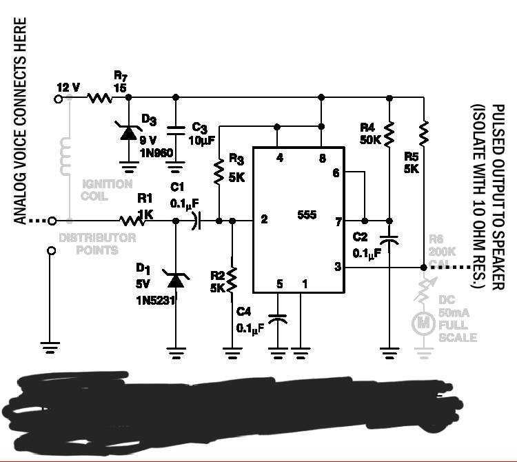

I was following this circuit that seems to work, which is a simple pulse generator with the 555 chip, the circuit I was talking about before. Can I use this?
Sure, but that circuit will output pulses at audio frequencies (kHz). You are asking about RF frequencies which are a million times higher and the circuits are much, much harder to design and build. A 555 can't come even close to outputting a signal 1 GHz (I think the max frequency is something like 1 MHz).
The "easy" solution would be to use the output from such a circuit to modulate a 1 GHz signal coming from using a mixer.This is very not difficult if you are using off-the-shelf components (small boxes) but these are quite expensive (a few hundred dollars) and you would at the very least need access to a high speed oscilloscope and preferably also a spectrum analyser to test and tune everything.
Note, however, that the moment you connect this to an antenna you WILL be breaking the law. It does not matter that you are only planning to use this at home or at the university. RF signals travel VERY far and any form of "pulsed" scheme will end up creating a LOT of interference which could easily create problems for others. Not to mention the fact that you need a license to use the 1 GHz band in the first place.
My understanding is that the FCC is able to issue some very serious fines for that kind of violation. ,

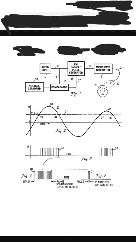

hi on the internet I found some notes on the construction of the transmitter, in these images there are the components, but I would like something that has everything inside
Snoopy1234 said:
hi on the internet I found some notes on the construction of the transmitter, in these images there are the components, but I would like something that has everything insideView attachment 276710View attachment 276711
And now we see that you are still trying to illuminate a human with a pulsed RF source to try to get audio conversion. As you were told in your previous thread, it would take dangerous levels of microwaves to get the non-linearities needed for such a demodulation.
This thread is closed. Please do not post about this "project" again at PF.
