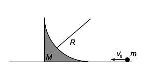

I have also a similar problem, you can see the image.
In this the mass m, start with an initial speed [itex]v_0[/itex], you have to find [itex]v_0[/itex] so that the material point has maximum height R.
I think that is right to use the two equations:
[itex]\frac{1}{2}m{v_m}^2+\frac{1}{2}M{v_M}^2+mgR=\frac{1}{2}m{v_0}^2[/itex] energy
[itex]m{v_m}+M{v_M}=mv_0[/itex] momentum
for the point of maximum height, and then you have [itex]{v_m}={v_M}[/itex] , because the two bodies are in contact.
Next time, you should put a new problem in a new thread.
That appears correct.
