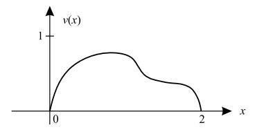

A certain function ##v(x)## has Fourier transform ##V(\nu)##. The plot of the function is shown in the figure attached below.
For each of these functions give their Fourier transform in terms of ##V(\nu)##. And also state if the FT is Hermitian/anti-Hermitian, even/odd, imaginary/real.
(a) ##v(2x)##
(b) ##v(x)-v(-x)##
(c) ##v(x+2)+v(x-2)##
Properties of FT.

The plot for v(x) looks odd so V(ν) has to be odd. But since we don't have an explicit expression for ##v(x)##, how can we determine if ##v(2x)## is even/odd? Likewise how do we know if his function is real? :confused:

Just as in part (a) and (b), I am not sure how to determine if the function is even/odd, real/imaginary. Any help would be greatly appreciated.
No, it does not. How come you arrive at this conclusion? I think, even if the wording of the question asks you to decided between any a pair of options, there is a chance that the answer does not belong to either options. In this case, one can just say that it's neither odd nor even, or neither real nor imaginary.
My mistake, I think it is neither even nor odd. It is not even as it is not symmetric about the y-axis, and not odd since it doesn't appear to satisfy the definition of odd function (##f(x) = - f(x)##). So, this function's FT is also neither even nor odd?

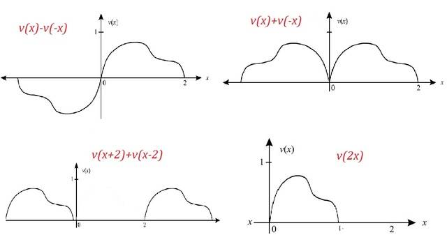

blue_leaf77 said:
Start from the sketch of ##v(x)## you already have.
Here are the sketches I made for the different cases:
Four sketched graphs of v(x) against x, labelled v(x)-v(-x), v(x)+v(-x), v(x+2)+v(x-2) and v(2x), each with a curve supported on the interval from 0 to 2 and its reflections.
Hopefully these are correct.
So ##v(2x)## and ##v(x+2)+v(x-2)## are neither even nor odd. But ##v(x)-v(-x)## is odd, and ##v(x)+v(-x)## is even.
blue_leaf77 said:
In particular for a), do you think a scaling can alter the parity of a function?
No, it can't.
Yes, your pictures are correct.
