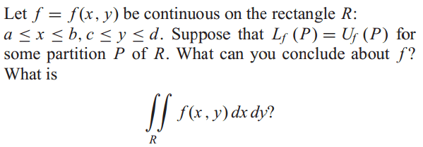

There are 2 questions which deal with the concept of double integration. I think there's no need for any calculations, which might have been easier, in my opinion.
1.
2.

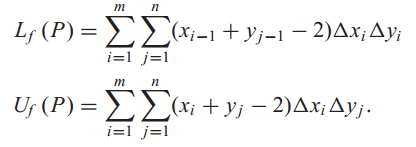

$$L_f(P)\leq I\leq U_f(P)$$
Example, for f(x,y)=x+y-2
1. Given the condition that ##L_f(P) = U_f(P)##, i would say that the partition P of R, would need to be a point. Therefore, since R is a rectangle, i would say that f is a simple line (straight or curved) on that rectangle? Or is f just a point on that rectangle? I'm not sure how to visualize this problem. Is there a trick to understand this?2. I'm not sure i even understand the first part about the original f being continuous. I try to imagine the original f as being a piece of string and the shape is irregular, as for the boundary of Ω. Then, stretch that irregular shape to fit into the rectangular shape, R. Is that a correct assumption? Do i need to consider this in terms of 3D?
How can a partition be a point? I suspect you do not have the right mental image for f, P, Lf(P) etc. here.
f is a real function on R. For each point of R, f takes a value at that point. If you think of R as being in the horizontal plane, you can think of the value of f at (x,y) as a height above it (could be negative). So f defines a surface in 3 dimensions. The integral of f over R can then be thought of as the volume below the surface and above the plane of R (counting volume as negative where f is negative).
In 2D, P cuts R into a grid of rectangles. Lf(P) puts a lower bound on the integral of f over R by taking the lowest value of f in each little rectangle of P and taking that to be the value of the whole minirectangle. Likewise Uf(P) gives an upper bound by taking the highest value within each minirectangle. If one is a lower bound and the other is an upper bond (as in the equation you quote in the OP), and they turn out to be equal, what can you say about the actual integral?
What do you know about continuous functions?

Go back to the definitions. What are [itex]M_{ij}[/itex] and [itex]m_{ij}[/itex]? They are
[tex] M_{ij} = \sup\{f(x,y) : x_{i-1} \leq x \leq x_i , y_{j-1} \leq y \leq y_j \}[/tex]
and
[tex] m_{ij} = \inf\{f(x,y) : x_{i-1} \leq x \leq x_i , y_{j-1} \leq y \leq y_j \}[/tex]
It happens in the example you give that [itex]x + y - 2[/itex] is increasing in both [itex]x[/itex] and [itex]y[/itex], and therefore that the infimum is attained at the bottom left corner [itex](x_{i-1},y_{j-1})[/itex] and the supremum is attained at the top right corner [itex](x_i,y_j)[/itex] of each rectangle. But [itex]f[/itex] could easily be such that both the supremum and the infimum are attained at points in the interior of a rectangle, and at different points in each rectangle.
Now
[tex] U_f(P) - L_f(P) = \sum_i \sum_j M_{ij}R_{ij} - \sum_i \sum_j m_{ij}R_{ij}<br /> = \sum_i \sum_j (M_{ij} - m_{ij})R_{ij}[/tex]
So if [itex]L_f(P) = U_f(P)[/itex], then since [itex]R_{ij} = (x_i - x_{i-1})(y_j - y_{j-1}) > 0[/itex] for all [itex]i[/itex] and [itex]j[/itex], we must have [itex]M_{ij} = m_{ij}[/itex] for all [itex]i[/itex] and [itex]j[/itex]. Therefore by definition, on each rectangle,
[tex]\sup\{f(x,y) : x_{i-1} \leq x \leq x_i , y_{j-1} \leq y \leq y_j \} = \inf\{f(x,y) : x_{i-1} \leq x \leq x_i , y_{j-1} \leq y \leq y_j \}[/tex]
What does that imply about the value of [itex]f[/itex] on each rectangle?
