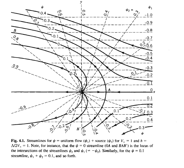

I don't even know where to start. I don't understand the question.

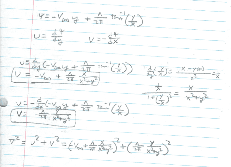

Have you learned that the speed of the flow is proportional to the magnitude of the gradient of the stream function?
do you mean
V^2=u^2+v^2
where
shreddinglicks said:
do you mean
V^2=u^2+v^2
where
Yes. But you need to express theta in terms of x and y to evaluate these derivatives.(except, of course, far upstream).

That's fine. I'm not here to learn math. Since I now have V^2 what do I do from here? I still don't understand the question I need to solve.
You need to show that, at the x and y corresponding to theta = 66.8 degrees and psi = 0, the speed is the same as at y = 0, x = infinity

So I know at a large value of -x and y= o that my V^2 is equal to 1.
would it be appropriate to sub in
x=rcos(theta)
y=rsin(theta)
r=x^2+y^2
and then plug in 66.8 = theta

You have to evaluate it at psi = 0.

No. You should be setting psi = 0 and theta = 66.8 degrees (in radians). This gives you an equation for y. Once you know y and theta, you know x.
I see exactly what you mean. I must be losing my mind thinking psi is pressure. I did exactly what you said and got x and y. I plugged into the the V^2 equation and got 1 as my answer.
