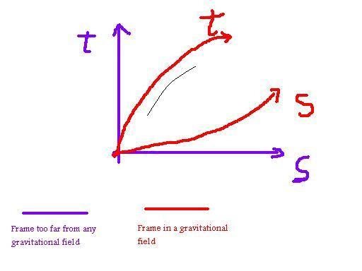

At last I understand the answer.So I explain it for others.
look at the attached picture.the black line is parallel with the red time axis.its the space-time path of an object which is at rest in the frame of someone inside the gravitational field.if you take the blue axis as the main ones(look at the object from outside of the gravitational field)you see an accelerated motion path.
In fact in the gravitational field,the object moves only in time but outside of it,the space-time path contributes to motion in both time and space.

Here you are confusing "motion in space" and "advance in space-time". The advance in space-time, that is affected by space-time geometry is not "started" by anything. It is simply postulated for all existing objects by the model.
Check the first picture here:
http://www.physics.ucla.edu/demoweb..._and_general_relativity/curved_spacetime.html
It shows how the geometry of space-time causes movement in space, of an object that was initially at rest in space (advancing only along the time dimension).

I don't quite understand what you mean, but you seem to be on the wrong track with the rotation of the Earth. It is not relevant. The surface of a non-rotating planet is still considered accelerated in GR. Only free fallers are inertial.
Here is an interactive diagram of a free fall through a non-rotating planet:
http://www.adamtoons.de/physics/gravitation.swf
Note that when you set "intial speed" to zero, the object still starts moving trough space, just by advancing straight ahead in space time.
