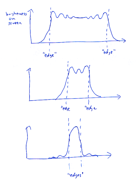

You always get diffraction around the edges of the slit. If the slit is wide, the effects are noticeable only near the edges of the "shadow" cast by the slit. If the slit is narrow (for the same wavelength), the two regions of "edge diffraction" merge and become the dominant effect.
Here's a sketch that shows the brightness pattern on the screen for different slit widths, for the same wavelength (approximately!).

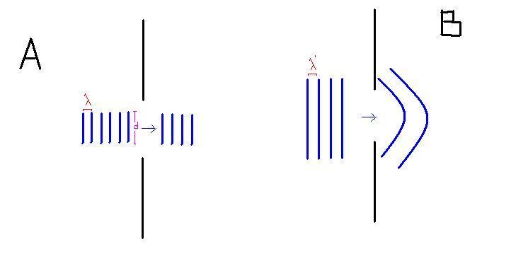

Hi, thanks guys .
I'm sorry I didn't ask my question properly! Let me try again with a more pro diagram.
In case A, you can see that the space between the edges of the slit is larger thant the lenth of the lines of the wave. Then, the wave pass through the slit "free".
In case B, the space is smaller (in comparision to the length of the wave).
My question was... if the refracction depends in the wavelength (lambda), and it is equal in both cases (you can see that lambda and lambda prime are almost equal), the difference then must be in the length of the lines of the wave in the diagram... but what does this length represent in "real" life? because I can't see any diference in the wavelength, and its suppose to be the main reason of diffraction!
And... how can be always diffraction?! How is it possible?
Thanks a lot!
Andrés.
ups, I forgot the attachment
The length of your lines would correspond to the spatial extent of the wavefront, not the wavelength. And what your drew is, strictly speaking, physically impossible- a planar wavefront must be infinite in extent.
But, your diagram 'A' is close to how a spatial filter operates- a focused beam impinges on a pinhole, with the diameter of the pinhole close to the diameter of the spot size. What emerges is a near perfect spherical wavefront, which can then be transformed into a cleanly collimated beam.
The spatial shape of the wavefront is critical in calculating diffraction effects, far more so than wavelength - wavelength simply gives you a reference scale.
As Andy Resnick said, diagram A is technically physically impossible since the wavefront must be infinite (or a very special type of beam) in order for no spreading/bending of the planar wavefronts to occur. A close approximation however is a standard Gaussian beam passing through a wide aperture at the beam waist. One would expect little, if any change to the wavefront due to the aperture.
Diagram B would then correspond to either a wider beam, (or a smaller aperture), in which case there would be significant change to the wavefront due to the aperture.
