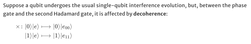

Talisman said:
Yes you do. In fact, he writes down the state explicitly!
If the second qubit is a random photon that happens to be passing through your experiment, you don't know the entangled state. You can't possibly.
I don't think you're actually addressing the issues I'm raising.

Please see the example again. He writes down the state explicitly: ##\frac{|00\rangle + |11\rangle}{2}##.
But it doesn't matter, because you can take the partial trace yourself and see that it results in the maximally mixed state that he (and others) equate with decoherence -- provided that you are thereafter unable to measure the "environmental" particle for whatever reason. That does not depend on MWI or any other interpretation.

Talisman said:
Please see the example again. He writes down the state explicitly: ##|00\rangle + |11\rangle##.
Again, you're not addressing the issue I'm raising. You can't know that the two-qubit system is in this state unless you prepared it that way. If the second qubit is a random photon that happened to pass through your experiment, you didn't prepare the two-qubit state, so you don't know what it is.
I realize Aaronson does not explicitly state in his article what I just stated above. That doesn't mean he disagrees with it. He just didn't say it. What I say is obvious. If you don't agree with what I say, then give me an actual argument. Don't just keep repeating what Aaronson says. I know what's in Aaronson's article. I also know that what's in Aaronson's article does not address the issue I'm raising.
The mixed state you obtain by partial tracing is independent of any interpretation, yes. I did not say otherwise. The only thing I have said is interpretation dependent is the claims made by the Bousso & Susskind paper you referenced, which explicitly uses the MWI.
  • #35
I already stated my objection to this position in post #24. Your only response to that was to say I'm far from the first to notice it and reference the Bousso & Susskind paper. I am unable to find anything relevant to that issue in that paper.
  • #36
I'm afraid we keep talking past each other, and I don't know how to resolve it. I will try one more time, but I am afraid I have reached the limit of my ability to communicate here.
Yes, I agree that you can't know the state of a random photon passing through your lab. And yet it is also the case that if you do prepare the two-qubit state as given, and measure only the first particle (and hurl the other off into space so that you can't measure it, or even simply decide to not measure it), the statistics of that first qubit for all observables will be identical to those of a qubit with definite relative phase whose phase information has been lost (or equivalently, averaged over all possible phases). "Decoherence" is a subjective interpretation given to the condition where it becomes "hopeless" to recover that particle (and whichever others got entangled), whatever "hopeless" means. Most of us would indeed consider trillions of air molecules and photons "hopeless" to carefully measure, but even a single one zipping off to Andromeda qualifies.
Not just the state of the photon, but the joint state of the photon and the qubit in your lab, if the photon becomes entangled with the qubit by some random interaction.
Then obviously your first qubit can't be entangled with some random photon that passed through your lab, because you prepared your first qubit to be maximally entangled with a second qubit that you control. So this is simply a different scenario from the one I have been talking about.
The reason I have been emphasizing this difference it that it explains why there is no decoherence in a Bell inequality experiment without having to make highly implausible claims about how whether or not decoherence is produced by entanglement depends on whether or not we measure the second particle afterwards. Instead, we have the much easier claim that whether or not decoherence is produced by entanglement depends on whether or not the entanglement is produced by a controlled preparation process or a random, uncontrolled interaction.
To put it as succinctly as possible: instead of saying "entanglement destroys coherence", I would say "uncontrolled entanglement destroys coherence". And I think the latter statement better reflects the overall theory of decoherence in the literature.
