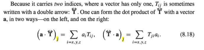

This section of Introduction to Electrodynamics by Griffiths, section 8.2.2 (page 363), is talking about the Maxwell's Stress Tensor. I do not quite understand what the j means on the left = sign (for either of the two representations) in the attached figure highlighted in yellow color. I have read about tensors and their Index Gymnastics but I still do not understand this notation. Any help is much appreciated.

The LHS is the jth component of the vector ##\vec a \cdot \overleftrightarrow T##.

How can j affect the summation on the right side of the equation? Does it decrease the tensor by one rank?
Each of the equations is really three different equations, one for every possible value of j.

How come they are different equations? Isn't it one equation, since we have the summation operator leading to different terms but added together to form one equation?
You do not have a summation over j. The j represents different components of a vector. If you take two vectors ##\vec v## and ##\vec w## that are equal, this is the same as saying that their components are equal. This would be written ##v_j = w_j##, which represents one equation for every possible value of ##j##. The equations you posted are really no different from this. They are telling you how the components of ##\vec a \cdot \overleftrightarrow T## and ##\overleftrightarrow T \cdot \vec a## relate to the components of ##\vec a## and ##\overleftrightarrow T##.

To be more specific. Writing out the sum in the first equation would give you
\sum_{i = x,y,z} a_i T_{ij} = a_x T_{xj} + a_y T_{yj} + a_z T_{zj}.
Letting ##j = x## you would now get
\left(\vec a \cdot \overleftrightarrow T\right)_x = a_x T_{xx} + a_y T_{yx} + a_z T_{zx}
whereas if you let ##j = y## you get the different relation
\left(\vec a \cdot \overleftrightarrow T\right)_y = a_x T_{xy} + a_y T_{yy} + a_z T_{zy}
and so on.
