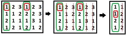

mean(mat[2, mat[1, ] == 1] == 1)
What does this R command translate into plain English?
According to my understanding:
243198
So the mean is: (1+1+2+1)/4 = 1.25.
Is my understanding correct?
If I am correct, what does it actually try to achieve?

It helps to break the problem down into steps:
  • First, consider what does mat[1,] evaluate as?
  • Next, what is the output of mat[1,]==1?
  • Next, what is mat[2, mat[1, ] == 1]?
  • Next, what is mat[2, mat[1, ] == 1] == 1?
  • Finally, you can calculate mean(mat[2, mat[1, ] == 1] == 1).
Given the matrix you provide in the OP, I get 0.5 as the final answer.
