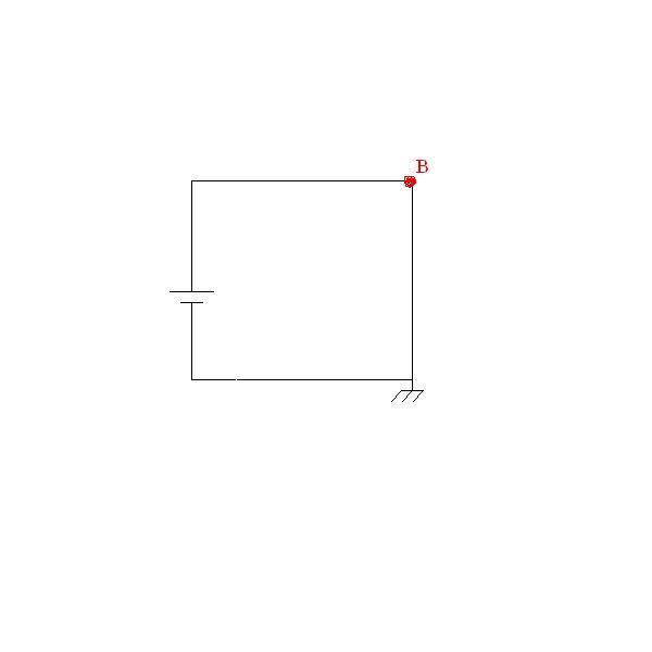

Only voltage source and wire?(PLEASE SEE THIS!)
Suppose a voltage source of any value(eg:5V,10V etc) is connected with a wire and that's all about the circuit,nothing else (resistors,bulbs or any kind of loads) is connected with the circuit.Assume that the internal resistance of the wire is totallyzero ,then what is the voltage drop and current at point B?(see the attached figure)Would the current flow become theoretically infinity? and voltage drop is zero?

Yes, but you can only get a wire like that at area 51. It's hidden in the lab where they divide by zero.
In case you were wondering, superconductors cannot carry infinite currents. They have limits where they break down and turn back into normal conductors.
A voltage source (ideal) has zero resistance an an ideal wire also has zero resistance. That would mean infinite current. Neither of the components you propose actually exist so the thought experiment goes nowhere, I'm afraid.
What you can say is that, if you connect a thick wire across a car battery you will either melt the wire of boil the battery. I was so impressed when I did it with a coat hanger wire and an old battery of my Dad's (years ago and pre- health and safety). The wire got to yellow heat and collapsed - be careful though, the wire can burn through you, the battery case and the floorboards!
Another thing about this, Ohm's law is really only an abbreviated description of electromagnetic phenomena. It's a subset of physics that's only useful for charged particles moving through real conductors that have resistance. Maxwell's equations combined with quantum physics explains electricity in much more detail.

voltage sources have an internal resistance. that internal resistance limits the available current.
i = Vs / Rs, where Vs is source voltage at open circuit, and Rs is the source internal resistance.

For the circuit in the original post, When the battery is connected, the current rate of increase is theoretically given by
dI/dt = V/L
where V is the battery voltage, and L is the inductance of the loop. Very roughly, the inductance is
L ≈ 100·μ0·d Henrys
where μ0 is the permeability of free space and d is the dimension one side of the loop (in meters). This is the EE equation for the magnetic energy mentioned by Okefenokee earlier.

"voltage sources" are ideal sources of PD with NO internal resistance. They are not real devices but idealised for the purposes of analysis.

To model a real source you specify an ideal voltage (emf) in series with a specific (internal) resistance.
I learned that at School and that's what is always done, in my experience,
