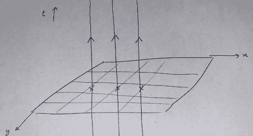

Thank you all for your insights; I won't pretend that that I have done any general relativity (I haven't...), and indeed this is the classical part of the forum (I don't know what the protocol is if the topic changes half-way through the thread!), however here's what I've grasped from what you've said:
Considering a 2+1 dimensional space, so that I can picture it, I've drawn the hyper-surface as horizontal and put the worldlines of the observers are perpendicular to this surface. I imagine we could then define a coordinate system on the hypersurface (I've drawn in some arbitrary ##x## and ##y## axes).
The following is taken from Astronomy and Astrophysics, Recent Developments, José Lemos:
In our discussion, we find necessary to make a distinction between "reference frames" and "coordinate systems" . By a reference frame we shall mean an observer set by which measurements are directly made. For example, a set of radially moving geodesic observers would comprise a frame of reference. On the other hand, a coordinate system refers to a set of numbers assigned to each point in the space-time manifold. In Newtonian physics a reference frame is an imagined extension of a rigid body and a clock. We can then choose different geometrical coordinate systems or charts (Cartesian, spherical, etc.) for the same frame.
But what is precisely a reference frame in general relativity? To build a physical reference frame in general relativity it is necessary to replace the rigid body by a fluid or a cloud of point particles that move without collisions but otherwise arbitrarily. One can define a reference frame as a future-pointing, timelike congruence, that is, a three-parameter family of curves ##x_{a} (A, y^{i})##, where A is a parameter along the curve and ##y^{i}## is a set of parameters that 'labels' the curves, such that one and only one curve of the family passes each point. If specific parameters A and ##y^{i}## are chosen on the congruence, we define a coordinate system. Of course, this choice is not unique. In general, a given reference frame can give rise to more than one
If I understand correctly, a "fluid" of observers need not maintain fixed relative positions. Consequently, what role does the stipulation that the worldlines of the observers are parallel play? Or is the parallel worldline case restricted to only SR? Indeed I've flicked through a few introductory SR texts which make reference to a rigid lattice of measuring rods and clocks, implying that perhaps the notion of the observers (in SR) retaining fixed relative positions isn't too bad an idea.

For SR you definitely want to think of an inertial reference frame as a grid of local observers, all at known coordinates and with synchronised clocks. That's my advice anyway. Several of the main textbooks emphasise this point. The alternative, which is widespread (unfortunately IMHO) is the "Bob and Alice" show, which emphasises individual observers.
And, yes, there are three differences between SR and Newtonian physics. Let's assume frame ##S'## is "moving" wrt frame ##S##. The grid of observers in frame ##S'## when measured in frame ##S## differs in:
1) The observers in the direction of relative motion are closer together (length contraction). The other dimensions, perpendicular to the relative motion are unafffected.
2) All clocks run slow, by the same factor as the length contraction.
3) The clocks are not synchronised (again in the direction of motion): "Leading clocks lag". If we imagine ##S'## is moving in the positive x-direction, then the clocks show progressively earlier times the further they are in the positive x-direction. Note that this has nothing to do with the transmission of light signals. These times are measured and recorded by the local observers in ##S##.
All of 1) - 3) are bundled into the Lorentz Transformation, which transforms the coordiantes in ##S## into the coordinates in ##S'##. Note that, by convention, the Lorentz transformation assumes a common origin for the two coordinates systems: i.e. the event ##t = 0, x = y = x = 0## cooresponds to the event ##t' =0, x' = y' = z' = 0##.
