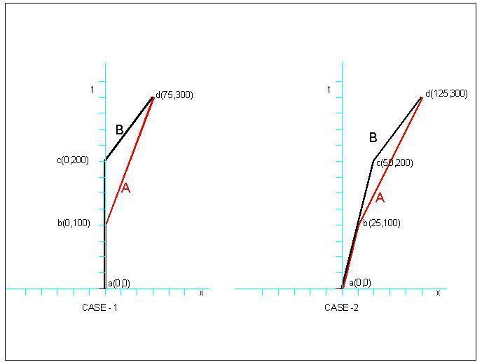

I tried to draw the diagram in Space time (with space of only x axis, considering y and z do not change). The result is interesting, since different from what I assumed and stated on 16th.
I am atteching a JPG file of the diagram.
with "proper time, T" based on the relation
dT2 = dt2 - dx2 - dy2 - dz2
In case -1, with A and B stationary with respect to the reference frame:
For A
T (a to b) = sqrt(100^2 - 0) = 100
T (b to d) = sqrt(200^2 - 75^2) = 185.4
Hence total time as measured(aged) by A = 285.4
For B
T (a to c) = sqrt(200^2 - 0) = 200
T (c to d) = sqrt(100^2 - 75^2) = 66.1
Hence total time as measured(aged) by A = 266.1
Hence B is younger when they meet again
Working similarly for Case -2, with A and B intially moving equal uniform velocity with respect to the reference frame:
For A
T (a to b) = sqrt(100^2 - 25^2) = 96.8
T (b to d) = sqrt(200^2 - 100^2) = 173.2
Hence total time as measured(aged) by A = 270
For B
T (a to c) = sqrt(200^2 - 50^2) = 193.6
Hence total time as measured(aged) by A = 259.7
Here again B is younger when they meet again

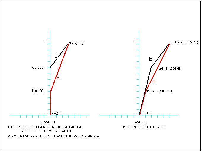

Now try Lorentz transforming the reference frame of case -2 in which they are moving at equal velocities to the reference frame of case -1 (i.e. "bend" back the "narrowed" axes of your second diagram). Aren't the diagrams the same?
The differences between Case-1 and Case-2 was bothering. I took the advice:
CompuChip said:
Now try Lorentz transforming ...
I updated the diagram with Lorentz transformation. With Case -1 as the base, I corrected the coordinated for 1, b, c and d in Case-2. The case-1 is with respect to v/c as 0.25.
With r = 1 / sqrt(1- 0.25^2)
x2 = (x1 + 0.25t1) * r
t2 = (t1 + 0.25x1) * r
With "proper time, T" based on the relation
For BOTH Case -1 and Case -2, I get SAME results:
Time measured by A from a to d through b = 285.4
Time measured by B from a to d through c = 266.1
For Lorentz Transformation, I referred to
http://hyperphysics.phy-astr.gsu.edu/hbase/HFrame.html relativity/Lorentz transformation
Excellent work mviswanathan. It seems like you understand the spacetime geometric approach to special relativity.
