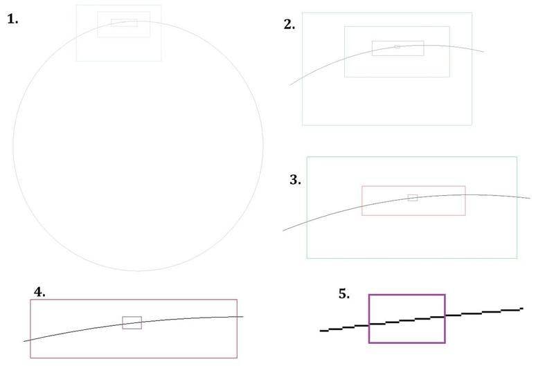

Does the beach ball represent the Earth with its curved surface and the line between the two dots represent the light from one point to another? Does this mean that as for us observers in the plane, light appears to travel in a straight line but if we look at it from the perspective of the surface of the earth, we see a curvature in the path of light?
The beach ball surface is an example of a curved geometry that is easy to visualize. 4 dimensional space time as far as I know is impossible for a human to visualize but it is the geometry through which light (and everything else) travels, and it is not flat. But I now think my post is a red herring for you - I suggest you follow the advice @PeroK gave in post 12 and @Ibix in post 13 and just clarify for yourself that light can definitely be observed to travel a curved path due to gravity.
I think the beach ball was just an analogy trying to point out that on a curved surface a geodesic is the closest thing to a line. Don't take it too much beyond that. But you'll notice that if you look at a very tiny piece of the curved line drawn on the beach ball, it will look straight (just like on Earth, locally it looks flat for the most part). Like with this MS paint I did, where I just copied portions of the circle and zoomed in (colored squares to help see):
So gravity curves light, but I doubt we'd notice it locally, unless we look in the distance and see how huge bodies curve light.
We do in fact see it on the large scale. It's how gravitational lensing happens. This wikipedia article has a bunch of animations that show what happens.
https://en.wikipedia.org/wiki/Gravitational_lens
