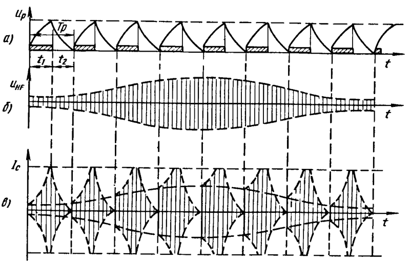

... how it works
- when there is some HF oscillation, C5 is getting charged, C4 discharged, C1 discharged with delay. So the average base-emitter voltage is getting less and less. The nanosecond pulses of the transistor current are getting weaker as the LC oscillator is getting damped (but still "sucking" last transistor current pulses via C3). Finally, there's practically no HF oscillation because the base-emitter voltage is too low and cannot be restored immediately (even though C5 is already discharging) because C1 cannot stop discharging immediately being delayed by C4. So the HF oscillation has to start anew some microsecond(s) later and that process of start is extremely sensitive to the input signal.
- the "Up" saw on this (not very accurate) picture is the emitter (C5) voltage, it's used as the output in that variant,
https://refdb.ru/look/1527014.html
thank you ver much i understand
