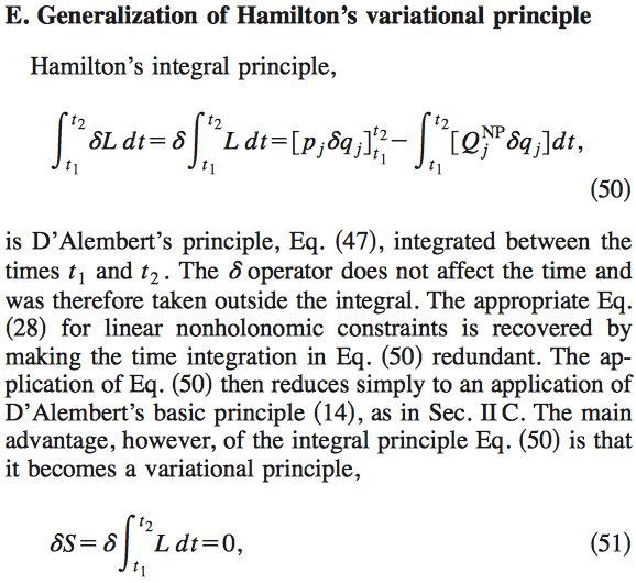

What does it mean by "making the time integration redundant" (5th line)? If I let ##t_2=t_1##, I will only get ##0=0-0##.
Source: http://www.phys.ufl.edu/~maslov/classmech/flannery.pdf

I don't pretend to know what half of this is about, but it looks to me that (28) can be got from (50) by differentiating wrt time. That certainly avoids the integration.

I think I figured it out.
##\delta q_j=0## when ##t=t_1## and ##t=t_2## since the end points are fixed as we vary the trajectory.
That leaves us with ##\int_{t_1}^{t_2}\delta L\,dt = -\int_{t_1}^{t_2}Q_j^{NP}\delta q_j\,dt##.
By "making the time integration redundant", we have ##\delta L = -Q_j^{NP}\delta q_j##.
Then by expressing ##\delta L## in terms of ##\delta q_j##, we obtain (14) and subsequently (28).
