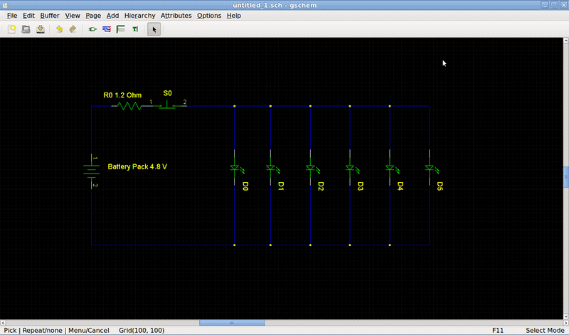

I am building a LED array and most of these LED resistor calculators like this one http://led.linear1.org/led.wiz, seem to suggest that I need more than one resistor for the array. From my Calculations I need 1.2 Ohm resistor/s. So my question is given a 6 LED array, why use 6 resistors rather than just one. Also why does the software/website put the resistors on the cathode side of the LED's?
Can you post a schematic of YOUR idea vs. THEIRs?

Unless the LEDs are well matched, their light output versus current will not be identical. So why do you think it would be a good design practice to use one resistor per not-so-well-matched LED?
BTW, in some LED lighting applications, the LEDs are well matched, and there is only one current going through a series string of the LEDs...
If you have several led's in parallel, one might get hot and begin to hog current. In that case it would get hotter, and the hogging would get worse. That's why high-current devices are needed - if we could safely leave diodes in parallel we would.

Powered by a 4.8V battery pack, using 6 Cree XP-G LED's.
The data sheet for these LEDs shows a possible turn-on voltage range of 3.3 to 3.75 volts.
If you did have such a variety, the one with the lowest voltage would turn on first and hold the voltage output of the resistor to about that value. The voltage will rise as that LED will draw a lot of current and this would light up some of the other LEDs but to a much lower brightness. So, you could get a wide variation in brightness.
If you did connect them all in parallel, and they happened to be perfectly matched, they would all get about 200 mA with that 1.2 ohm resistor. Quite safe, but probably not bright enough.
If you want uniform brightness from your LEDs, you could try individual 1.8 ohm, 5 watt resistors with one of these in series with each LED. It doesn't matter which way around the LED and the resistor are, as long as they are in series.
These LEDs are normally driven from a current regulator to get constant current for each LED, but this is difficult in your case because of the low battery voltage. So, the resistors are a bit of a compromise.

Well I want the the LED's to function as bright as possible, without damaging them. So would in series be better than in parallel like I have them now? Also how can I find out what type of resistor I need without using these online calculators?

LEDs have a turn-on voltage which is a minimum voltage that the LED needs before it will turn on. If you stack LEDs in series, the voltages needed to turn them on add up.
So, if you have two LEDs that both need 3.5 volts to turn them on, you will need 7 volts to turn them on in series.
You only have 4.8 volts, so you can't put them in series or none of them will turn on.
Calculation:
As a first step, have your 4.8 volt battery and a 3.3 volt LED. The difference between these voltages will appear across the series resistor. So, it will have 1.5 volts across it. 4.8 - 3.3.
For a current of 0.5 amps, this resistor should have a value of 1.5 volts / 0.5 amps or 3.0 ohms.
At this current, the voltage across the LED will rise to 3.4 volts, so the resistor must have a value of 1.4 volts / 0.5 amps or 2.8 ohms.
Your battery will rise to 1.35 volts per cell or 5.4 volts when fully charged, assuming NiCd or NiMH.
So the resistor would then be (5.4 - 3.4) / 0.5 or 4 ohms.
For a current of 1 amp, the calculation is similar and the voltage across the LED is now 3.5 volts:
So the resistor would then be (5.4 - 3.5) / 1.0 or 1.9 ohms.
1.8 ohms is near enough. Don't go any smaller if you can't find 1.8 ohms.
5 watt resistors are not as cheap as 1/2 watt ones, but much cheaper than high powered LEDs. The power is actually about 2 watts, but it will run hot, so a bigger rating would be better.
I would try one LED with a 3.3 ohm resistor, for a start.
