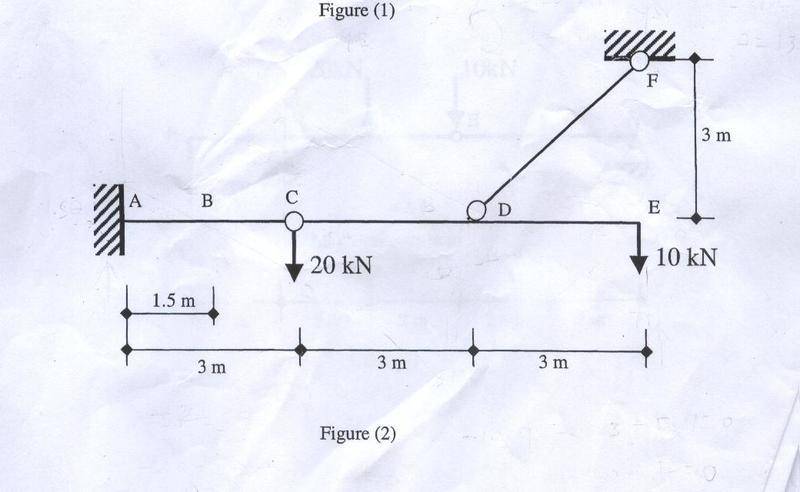

Im having real trouble with drawing diagrams for virtual work. Can someone please, please help me!
We were asked, in the diagram i posted, to find 1)vertical reaction at F, 2) all reactions at A, 3) bending moment and shear force at B using virtual work.
i think i know how to do the actual working out but to do that i need the diagram, which i don't know how to draw. Any help/explanation would be very much appreciated! thanks in advance!

To find the value of a statistical quantity Q at a point x0, draw the displacement diagram of the system "caused" by a differential displacement at the point x0 "in the direction" of the quantity Q, and apply the principle of virtual work. (Sounds nice in theory, I know, but this is still a hint. :smile:)

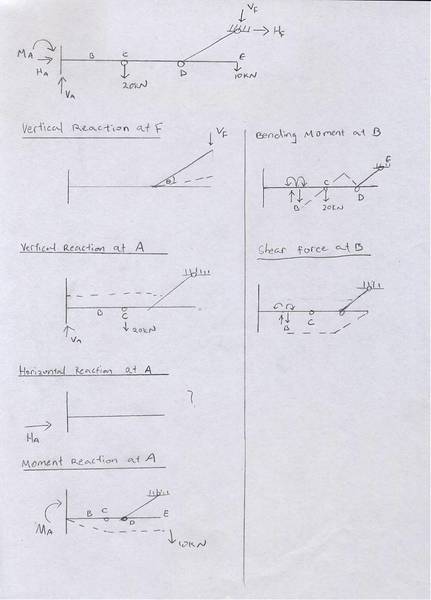

Ive realized, since posting the diagrams up, that i made a few mistakes in my attempted solution. Since it takes so long for attachments to be approved maybe i can just describe in words what i think and hopefully u'll be able to follow... :redface:
For the bending moment at B, I've used the convention in my worked solution. However I've modified the diagram like this: The force acting on the beam will turn the beam clockwise, so it will slope down from the top of B to D, passing through C. From D to E it will be a straight constant line. The extension from D to F will be like it was in the original diagram.
Thus sum bending moment at B=0
M(B) x d* + (-)V(B) x 1.5d* + 10kN x 3d* = 0
M(B) x d* + (-)(-20kNm) x 1.5d* + 10kN x 3d* = 0
M(B) + 30 +30 = 0
M(B) = -60kNm
NOTE: V(B) stands for the shear at B. i worked it out to be -20
d* is the angle between the virtual line and the real line
However using statics i found the moment at B to be -30 not -60. Did i draw my diagram wrong? Or is it my working out? thanks in advance!

Your diagram is wrong. If you find it hard to picture the displacement of the system, you can always use Kennedy's theorem to draw the exact displacement diagram.

Well, what I'm talking about is no hard way. First of all, do you know how to draw displacement diagrams for mechanisms?
Yes, i think so. I know that the displacement diagrams can bend at pins but must pass through the roller/rocker supports etc, and remains zero at fixed supports. And initially it goes in whichever direction the force is acting.

Ok, http://usera.imagecave.com/polkijuhzu322/pf/displ.JPG" the displacement diagram of the system (for the bending moment at B). I named the disks "i" and "ii". Of course, you have to add the forces to the diagram and use the principle of virtual work now.
Edit: your statics seems to be wrong too, since the moment you should obtain does not equal 30.
So in the diagram, where did DF go? Or it doesn't move?
Yes using the diagram the moment at B should equal 15...my statics was wrong but i know wat went wrong now :-)
The member DF isn't important, since there is no force to do any work on that member. (Formally, DF can't be seen in the diagram; it coincides with the projection of disc ii.)
