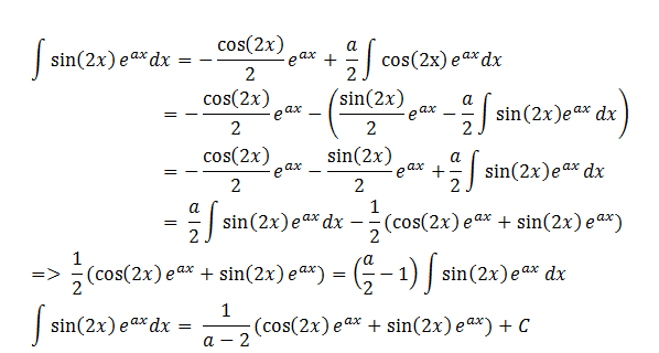

Thanks for your input!
What I did was simplifying
[itex]\int \frac{Be^{(2-\sqrt{2})x}(4+sin(2x)-cos(2x))}{-2\sqrt{2}ABe^{4x}}[/itex]dx
to
[itex]C(4\int e^{ax}dx + \int e^{ax}sin(2x)dx - \int e^{ax}cos(2x)dx )[/itex]
Where [itex]a = -2-\sqrt{2}[/itex]
I then started integrating the 3 integrals. First one was no problem, and I thought the second one was rather easy too. However when I checked my answer on wolfram, it seems like I'm way off. This is what I did:
Handwritten derivation integrating sin(2x)e^(ax) by parts twice, rearranging terms, and concluding that the integral equals (cos(2x)e^(ax) + sin(2x)e^(ax))/(a - 2) + C.
Does anyone see what I've done wrong?

[tex]\int(e^{ax}\sin(2x)\,dx = \frac{1}{a} e^{ax} \sin(2x) - \frac{2}{a} \int e^{ax} \cos(2x)\,dx.[/tex] so you started off making a basic error and it went on from there. Anyway, you don't need to check using Wolfram; all you need to do is differentiate your answer to see if it reproduces the integrand. You should always perform such a check whenever possible.
