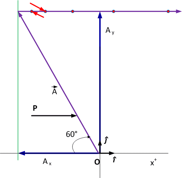

In this question , I'm asked to find the magnitude of P .
Resultant moment about O =
-10cos30 (4√3) -10sin 30 (10
+15sin30(2) + 15cos30(4√3)
-10cos30(4√3) -10sin30(4)
-15cos30(4√3) -15sin30(7)
+10cos30(4√3) +10sin30(11)
+P cos 60 (4√3) =0
P=22N , but the ans given is 15.6N , which part i did wrongly ?

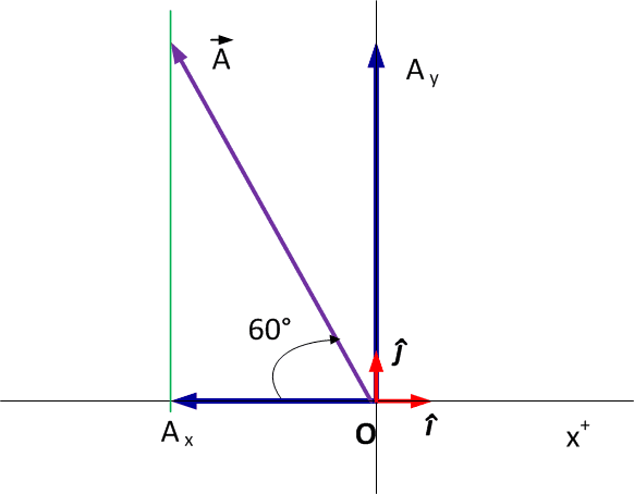

recognize this picture ? If ##|\vec A| = 12 ##, what is ##A_x## and what is ##A_y## ?
Ax = 12cos60 , Ay = 12 sin 60
So Ax = 6 and Ay is ... (not ##4\sqrt 3##).
Proceed to list the x-coordinates for the various points where the 10N, 15, 10, 15, 10 N act.
ok , then I'm sure the 1,2,4,7,11 is not correct ? what does those numbers mean ? then , how to determine the perpendicular distance for other forces which is situated at the right of the first 15N and 10N ?
Well, you have the y coordinates (at least if you filled in the dots in post #17 -- what did you get ?) and you have the horizontal distances to the leftmost point of the horizontal line where all these 10, 15 N forces act. What is the x coordinate of this leftmost point ?
I figured your post #1 doesn't deal with perpendicular distances but instead evaluates the ##\ \vec\tau = \vec r \times \vec F \ ## expression (##\ \tau_z = r_x F_y - r_y F_x \ ## )​

the y coordinates are all 12sin60= 6 surd(3)
i take the x coordinate of this leftmost point as {0, 0)
What, then is the x-coordinate of O ?
##\vec r## is a position vector ##r_x - {\bf O}_x## is a perpendicular distance only in the x-direction. You can split up the contributions of the force x and y components to the torque this way (as you do in post #1) because the expression is linear.
Good thing you found ##6\sqrt 3## instead of the ##4\sqrt 3##. So where are you now with the updated version of post # 1 ?

I hope this isn't driving you crazy ... :smile: I admire your resilience and patience.
The red numbers to me seem incorrect on first sight ( a bit pressed for time right now).
Simple check on the first line:
##10\cos{30^\circ}## N is a force to the left with a perpendicular distance 6√3 so it is a torque that wants to rotate to the left.
##10\sin {30}^\circ## N is an upwards force that wants to rotate to the right.​
in your summation they want to rotate in the same direction. Can't be right !
But we are getting very close to the correct solution by now, so keep up the good work !
Tip: mark the x and y components of the first 10 N force in the drawing of post #15. ##F_x r_y## is correct (no red there...).

"Everything in red" is the answer to your question. The red 0 force does not grab at the same x-coordinate as Ox, even if the bad bad bad picture let's you think so. Remember how you found the ##6\sqrt 3## ? Now find the x-coordinate of the leftmost point of the
horizontal line where it join all the 15N and 10N
From your post #20:
You simply can't do that. You already have point O as (0,0)

P=14.9N , which part is wrong ?
Please don't remove posts. It makes the thread incomprehensible for other readers !
-10cos30 (6√3) -10sin 30 (-3)
+15sin30(6√3) - 15cos30(-2)
-10cos30(6√3) -10sin30(0)
-15cos30(6√3) -15sin30(3)
+10cos30(6√3) +10sin30(7)
+P cos 60 (6√3) =0
Did you find the x-coordinate of the leftmost point of the "horizontal line where it join all the 15N and 10N" ? (It is not -4 )
BvU said:
Please don't remove posts. It makes the thread incomprehensible for other readers !Did you find the x-coordinate of the leftmost point of the "horizontal line where it join all the 15N and 10N" ? (It is not -4 )
is it (-6,0) ?
Yes. The cosine of ##\pi/3## is 0.5
