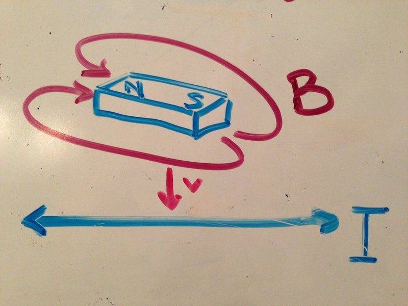

Ah, yes... here are pictures and other references to help demonstrate:
Here is the first picture to help visualize what I described in the beginning (basically if I were to create an electromagnetic coil with a driver nail as the inductor's core):
Here is the second picture demonstrating my main objective (given a magnetic force [ B ], relative speed [m/s], relative distance [d], and time [Δt], find the induced current of the wire ):
As a visual demonstration, here is a YouTube clip on 'Magnetic Induction'
Faraday's Law of Induction may be what I am looking for - using the Maxwell-Faraday equation:
∇ x E = -(∂B / ∂T)
(I am only just starting to re-learn all that goes with ∇ again - ie: gradient, divergence, & curl - so I can't determine if I found my answer just yet)
OK so the second wire ISNT the return wire for the first one
that's what we wanted to clarify :)
Here is the second picture demonstrating my main objective (given a magnetic force [ B ], relative speed [m/s], relative distance [d], and time [Δt], find the induced current of the wire ):As a visual demonstration, here is a YouTube clip on 'Magnetic Induction'Faraday's Law of Induction may be what I am looking for - using the Maxwell-Faraday equation:
∇ x E = -(∂B / ∂T)
This is the vital relationship. The magnetic flux, linking the circuit must be changing with time. Stationary or DC won't induce any voltage. Why not just go to Wiki and see what they have to say about electromagnetic induction? (Note the Counterexample in the Wiki page, though)
Be careful about that YouTube video. Electrons are not the slightest bit like the way they're shown. Just stick to 'Current' if you can .

Yes, I know stationary and DC sources won't induce any voltage - my design is really a spinning motor-generator (similar to those used in the old Lego Mindstorms), and yes I did read the Wikipedia article: 'electromagnetic induction' before sharing the above images and duly noted the counter examples near the bottom - I reference the Maxewell-Faraday equation because of it's accuracy. (non the less, thank you for your suggestion)
I haven't yet figured out how curl (∇ x E) works in vector calculus, but are you suggesting I found my answer already?
(just want to confirm - solve for B which includes distance, then solve the partial derivative given change in time, which should yield the curl of the induced current)
