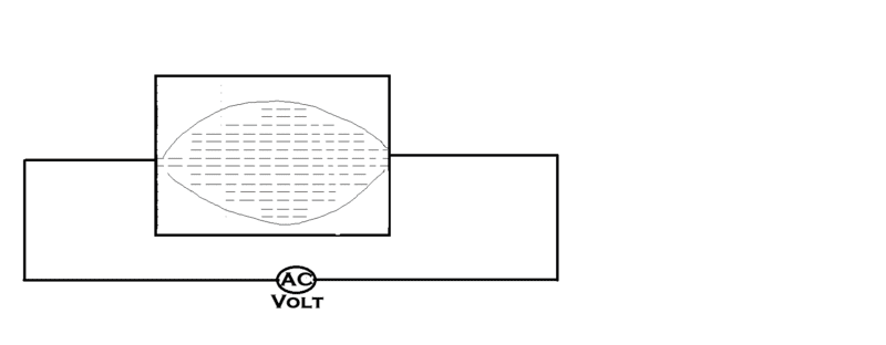

How current flows in Wide sheet or plate. Is it uniform pattern or something else?
Current flow through a wire is considered (or assumed) to be flown uniform across the cross section of the wire (or is it more near skin? or at core?). However I wonder if that's the case with a sheet or plate or circular disc. e.g. If I apply voltage at two opposite corners of the square or exactly in the middle of the plate. How the current will flow?
I know in transformer the thin plates are used to reduce the eddy current effect, but this is not what I'm tying to understand. I want to know how current will flow through the thick and wide object.

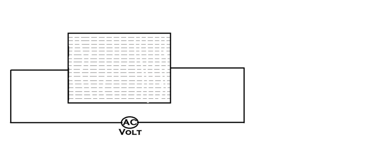

I've attached few options and I was wondering if someone have experimented this and knows the real answer? Assume that Rectangle plate of 3 mm thickness and 18 x 12 inches long/wide is applied AC voltage in the middle as shown below. In first case I showed dotted lines as current flow path... which is parallel to each other across the length of the sheet. In second case, it is somewhat elliptical or something like that. Just try to imagine it as it doesn't reach the corners uniformly but flows as it finds its way in sheet.
Or is there any other pattern, the current will flow? Anyone have idea or have experimented this?

More like your second picture. The current will flow everywhere across the sheet. But the paths that deviate from the center will have less current because their longer path length creates more resistance. You don't need an experiment, it can be calculated (but not easily). IRL it would be a computer FEA program that would solve it.
Maybe a (not so great) analogy is a crowd of people trying to walk across the sheet. When the direct path gets crowded, they move to the outside.

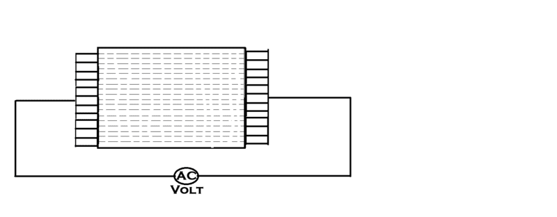

So to make it flow uniformly, in parallel, can we split current using connections as shown in below diagram?

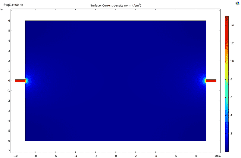

I've simulated it and here is the result for the current density norm

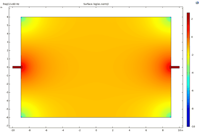

and its logarithm
(A potential difference was applied to the outside edges of the "wires.")

yes. but close to each contact point you still get the spreading out effect as before.

OK, but in the sheet the current is 10A. You need to think in terms of current density in a local region, or electron flux through an area. Notice in @DrClaude's plot the scale is A/m^2. The problem is linear, so the current density at location for a 10A source would just be 10x the answer for a 1A source. So, percentage of the source current is a good way to describe it. That's sort of what he posted already. The pictures won't change, just the scale on the side. The log scale is needed for us to see anything interesting since, as others said, the current density is really big near the contact point.

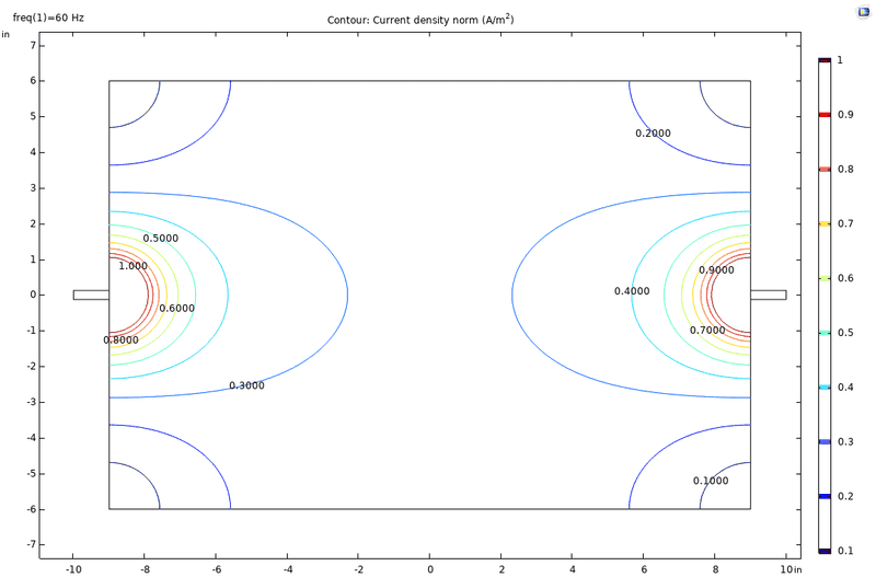

From the First image by @DrClaude, based on Color, I feel that the 90% of sheet have almost same current distributed equally (which could be somewhere around 1 amp or less than that). So my point was, if the simulation software can show numbers on the sheet (may be on current paths/bands), then it would be more informative. Or may be the paths are so thin that it may show very small current running parallelly and then it converges to total input value.

There are a huge number of current paths on the plate, all changing width. If instead of asking for current paths, you ask for equipotentials, then those will be orthogonal to the currents. The currents were probably computed from the equipotentials in the first place.
Here is a contour plot of the current density
