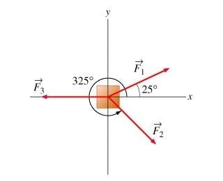

1) A block is affected by three forces, and I have found the direction and magnitude of the resulting force, and thus the direction and magnitude of the acceleration. I know that the magnitude of the velocity vector for t = 5 is 4.7 m/s and that the distance traveled for t = 5 s is 12 m.
The question is, in which direction the mass is moving at time t = 5 seconds?
It seems like I need some more info? Or am I missing the big picture here?

1) Calculate the magnitude of the total resultant force acting on the mass.
2) What angle does the resultant make with the positive x axis?
3) What is the magnitude of the mass's acceleration vector?
4) What is the direction of the acceleraton-vector? In other words, what angle does this vector make with respect to the positive x axis?
5) How far (in meters) will the mass move in 5.0 s?
6) What is the magnitude of the velocity vector of the block at t = 5?
7) In what direction is the mass moving at time t = 5? That is, what angle does the velocity vector make with respect to the positive x axis?
Wouldn't the direction of the velocity just be the direction of the acceleration? Or was there an initial velocity?
Any other information? It would be good if you could post a picture... I'm still unclear about the problem...
It is initially at rest on the surface, and the forces on the picture are:
F1 = 4N
F2 = 6N
F3 = 8N
I think it has the same direction as the acceleration.

I think that it is a problem of linear dynamics. Hence as there is no initial velocity the direction of the mass would be in the direction of the resultant force. More over velocity is in the direction of the resultant force. So as learning said acc is in the direction of velocity.
